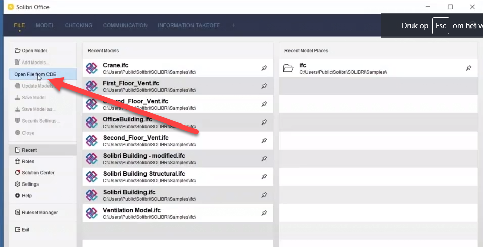

          Thanks for the quick response.
          In the video I see that there is already a possibility in Solibri to load models from a CDE. If it were also available for Trimble Connect, that would help a lot too.

            Hey @RemcoB,
            in fact, this is exactly what I referred to as promising results of the prototyping/research phase - good to hear, that it hits some nail on the head 😉
            But we are still in the development and there has been no official version of the API specification approved yet, so that Trimble Connect, for example, could implement something already on their side. But this is exactly what we are currently pushing forward on.
            So please stay tuned 😉
            Cheers
            Cornelius
