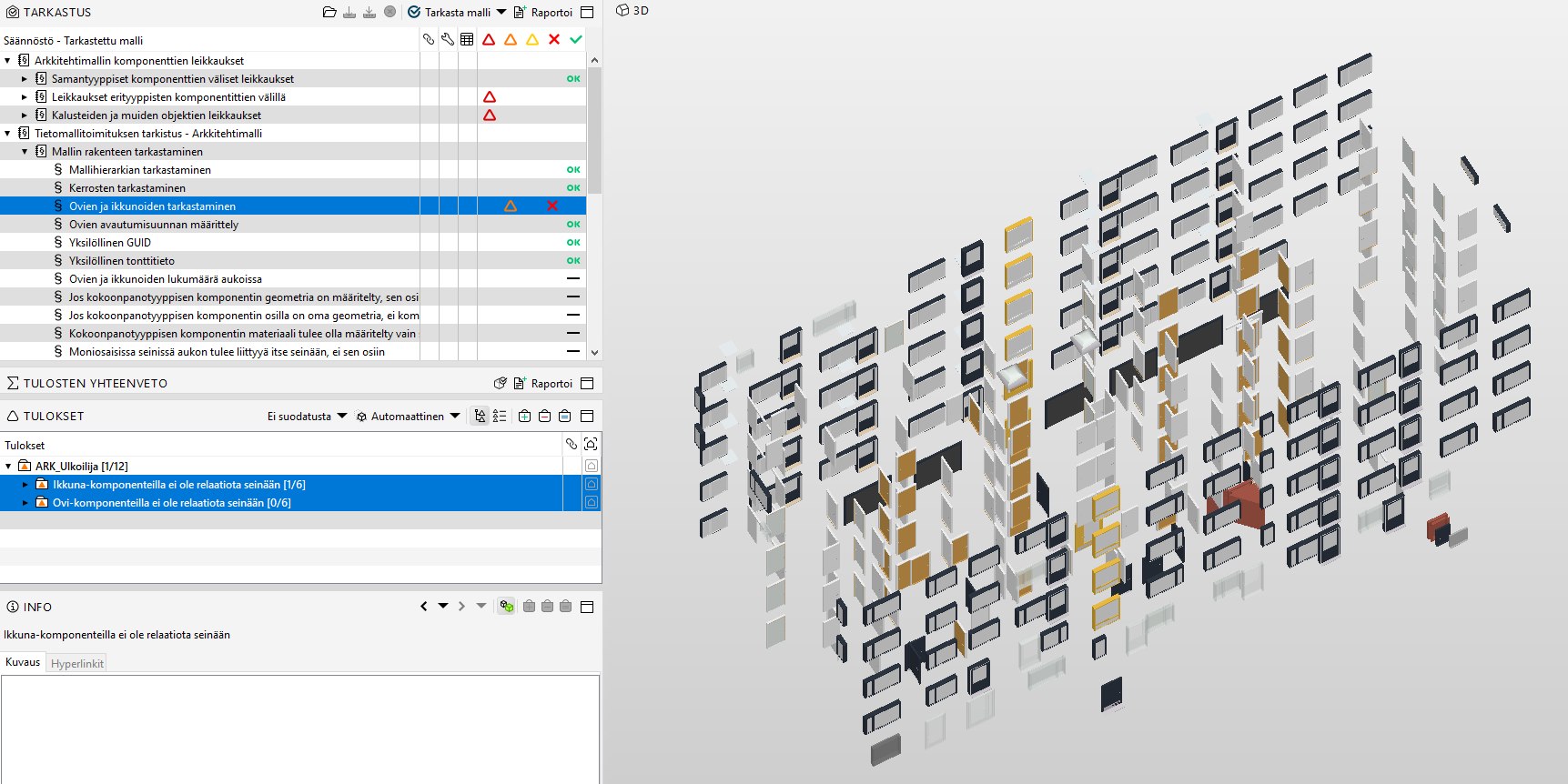

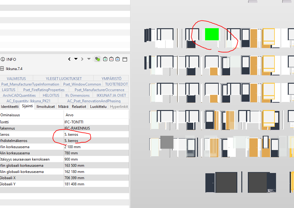

    SOL/176/2.2 ilmoittaa mielestäni turhaan relaatiovirheen. 74234a2b-6514-4db0-9c62-d0ab014caf37-image.png b0107014-fa41-4605-a037-b7bb7bba48b9-image.png

      @Jonna-Lehto
      In the picture the rule is giving an issue about doors/windows not having a relation to a wall, not to a floor.
      The relation between doors/windows and walls is through a opening component. Please check if there are openings exported and if the opening has a relation to the wall and door/window.
      Best regards,
