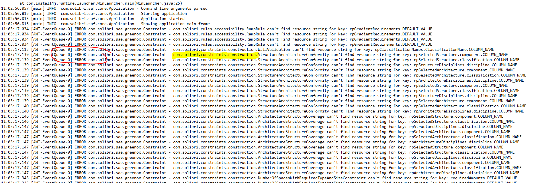

        Thank you for that tip - I took a look at the logs, and found the error that could be leading to the libraries not loading (please see below).
        I took a look through the forums to see if anyone else has previously talked about how to resolve an issue where Solibri can’t find a resource string, but haven’t been able to find anything on this topic. Would anyone be aware of how to solve this by any chance?

          Hi. Those “errors” will not crash it. They are really warnings about Solibri not finding translations for some texts. So it is likely something else.
