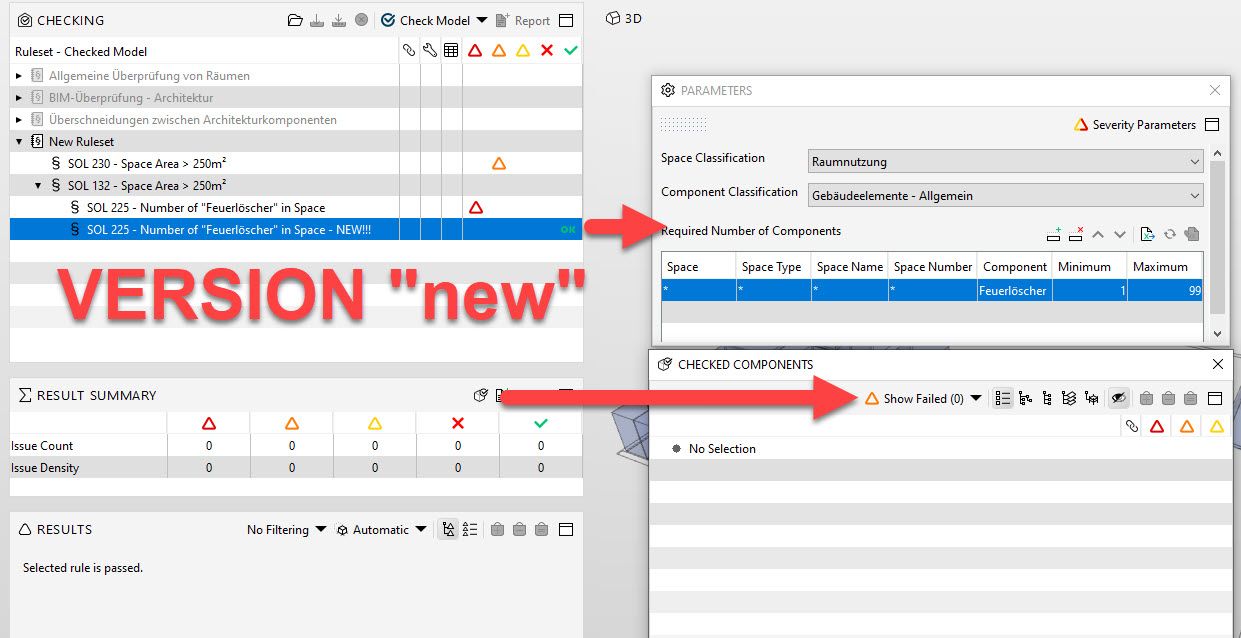

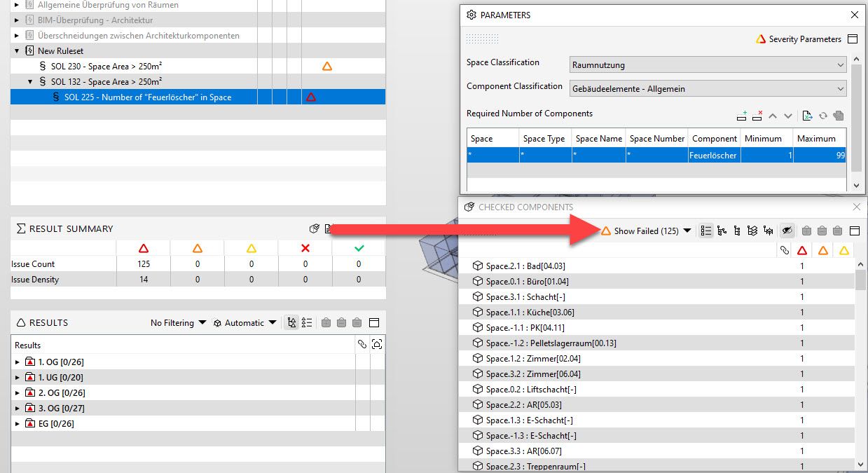

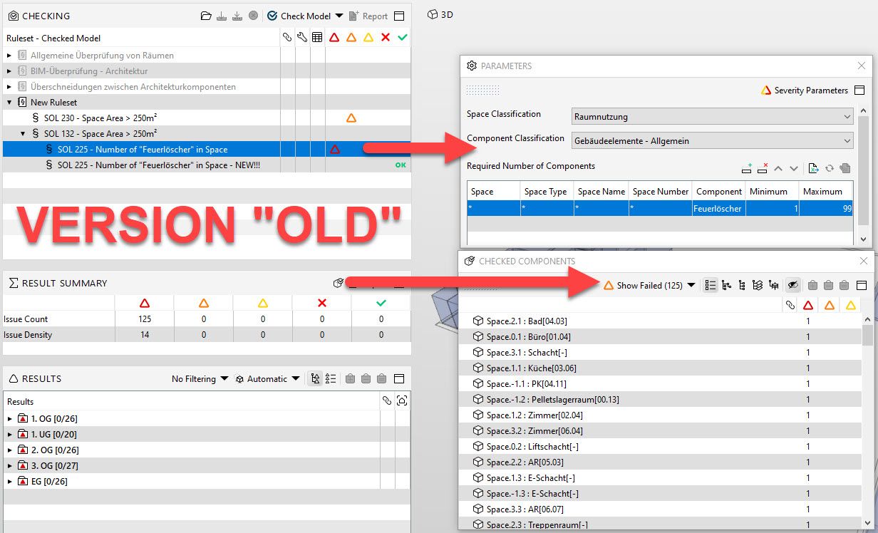

    There seems to be a new BUG in the latest version regarding Gatekeeper rules - something that has worked flawlessly before.
    there seems to be a difference where you create and check the rule:
    If you create a Rule as a standalone and check it, then the results are somehow memorized. If you move this rule under a Gatekeeper rule, the rule shows unfiltered results… and vice versa.
    if you move them on the same level you end up with two identical rules that show different results.
    in following image it is shown that same rule SOL 225 will then show different results:

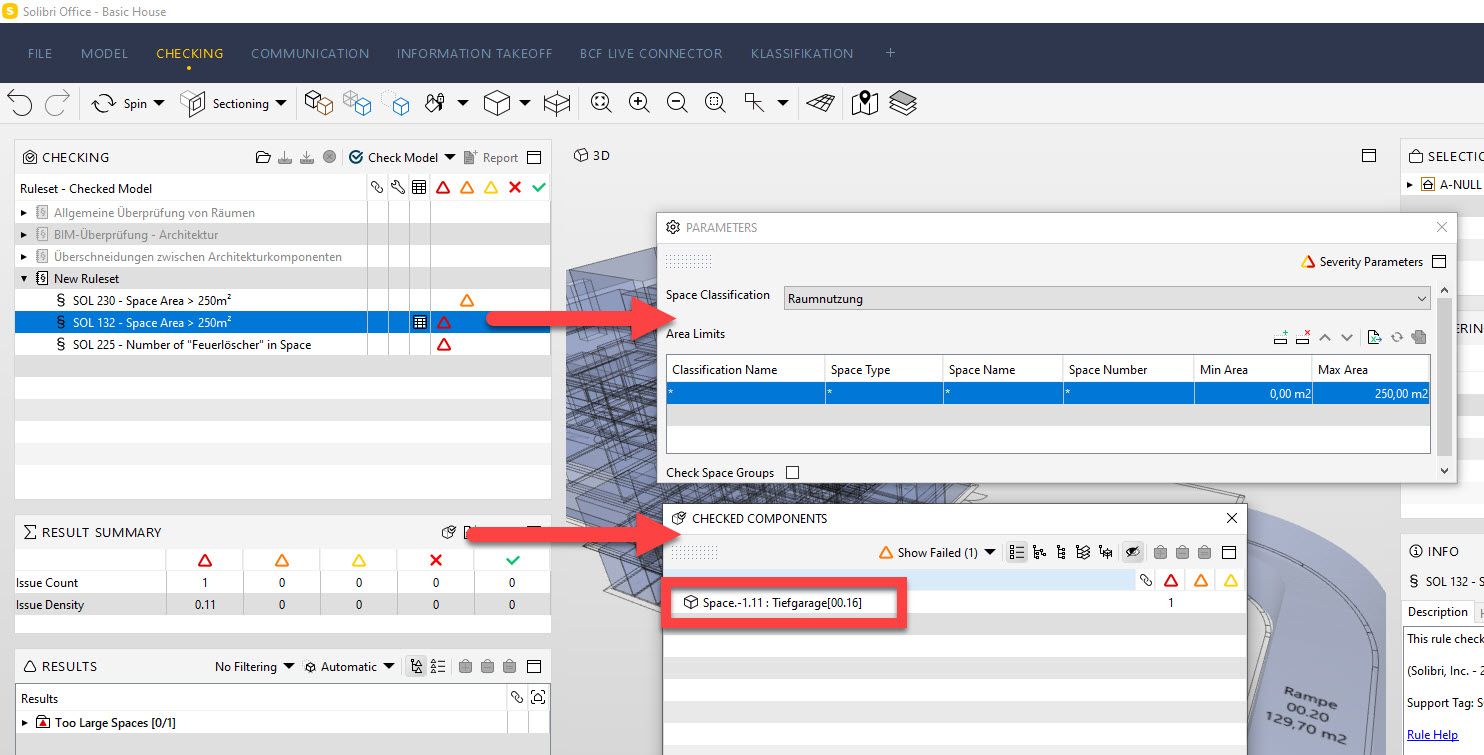

        1. I create SOL132 to check for Spaces above 250m²…and CHECK (results 1 Failed - “Tiefgarage”)

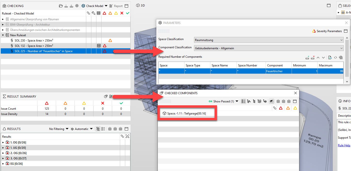

        2. I create SOL225 to check for “Feuerlöscher” in Spaces…and CHECK (results 1 Passed - “Tiefgarage”)
        3. I connect SOL132 and SOL225, while SOL132 acting as Gatekeeper with “Check only failed Components”…and CHECK (results should have been OK, but I get many failed components)
        Here are some pictures:

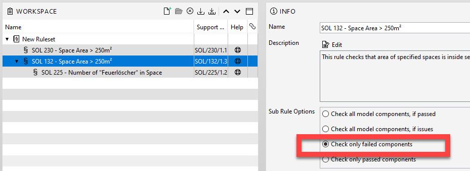

        3. I connect SOL132 and SOL225, while SOL132 acting as Gatekeeper with “Check only failed Components”.

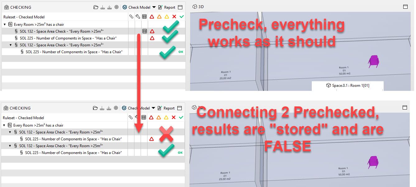

          This is quite an OLD Problem (6 months) that still has not been addressed in the current release 9.12.5.
          It is a serious problem dragging old results in the gatekeeper rules and vice versa.
          here again an image illustrating the problem and the SMC file:
          Gatekeeper 01.jpg gatekeeper.smc
