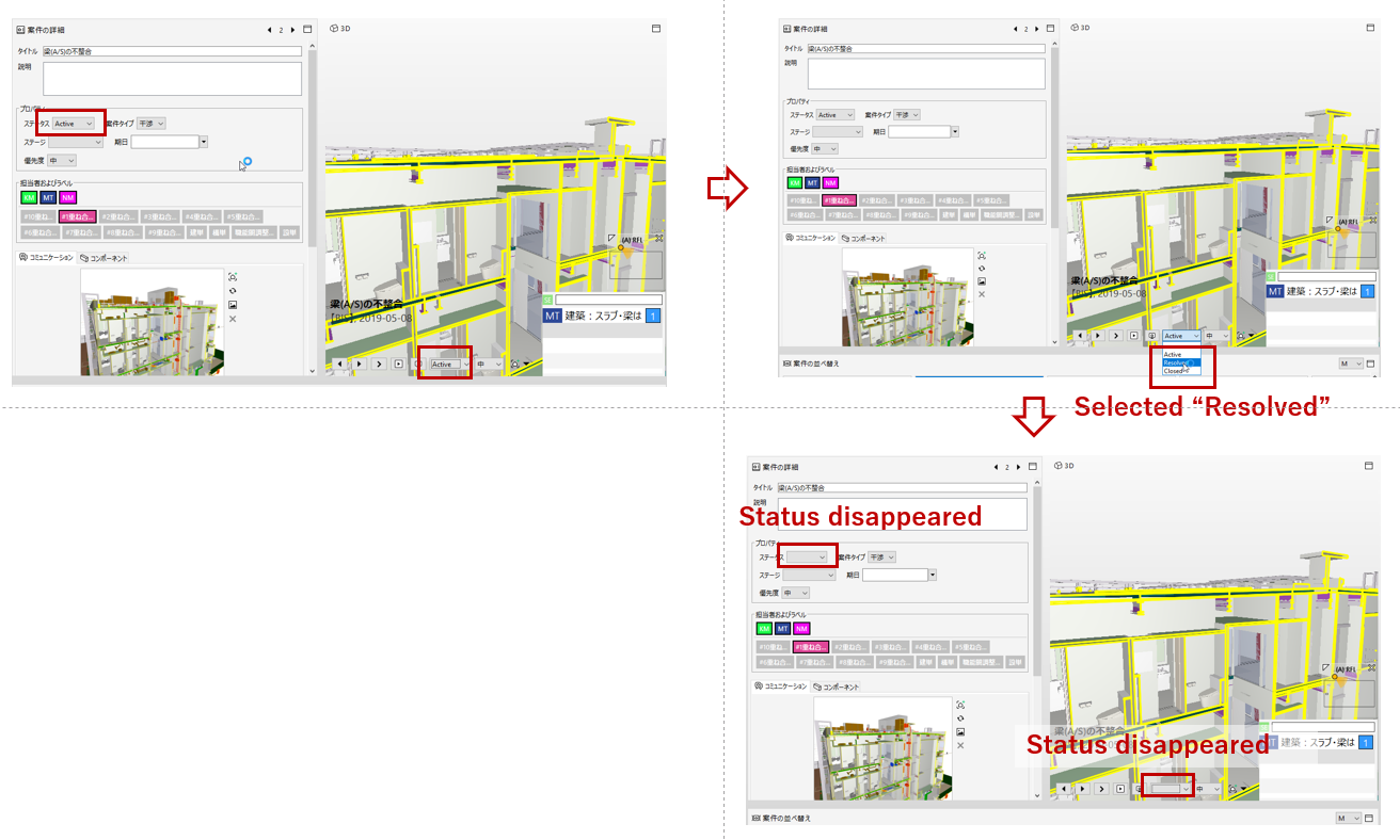

    REPRODUCIBILITY: 100%
    BUILD VERSION/ENVIRONMENT: 9.12.0.11
    PLATFORM: Win10
    CONFIGURATION:
    LANGUAGE: JP
    DESCRIPTION:When I change the issue status in 3Dview, the status disappeard
    PRECONDITIONS:
    STEPS TO REPRODUCE:
    Please see the attachment screenshots
    EXPECTED RESULT:
    Status appeared as I selected
    ACTUAL RESULT:
    Status disappeared
    ADDITIONAL INFORMATION:

      Hello @tomoki,
      Thanks for the report. This has been reported by other users as well, and a fix is currently underway to be included in 9.12.1.
      For the time being, it seems that this is related to sorting issues by status or modification date. Sorting the issues list by number may help in some cases.
