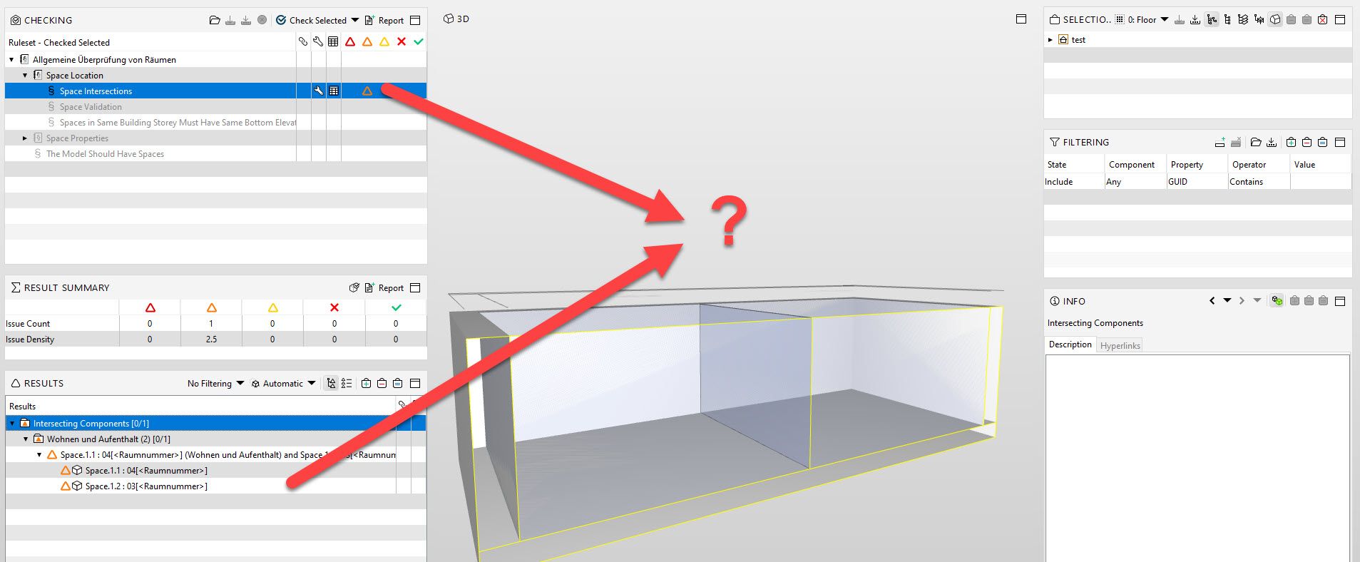

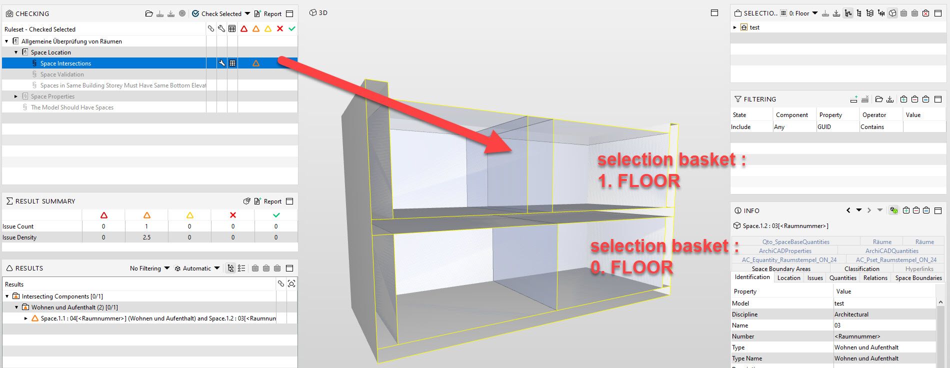

    Version 9.12 has a Major Flaw…something that has worked perfectly before:
    If you check something, these results appear to be stored somewhere in the Rule. If you change the setup, that a rule check only “Check Selected”, the results are not updated.
    1. I have created a simple model where 2 spaces on the top floor are intersecting and 2 spaces on the ground floor are not intersecting.
    2. After the check, the top spaces are shown as Moderate Issue, which is correct.
    3. then I created the selection basket, with only the bottom floor
    4. after “Check Selected” the top floor components (which are not in the selection basket) are shown in the results
    how is something like this possible?

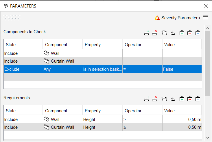

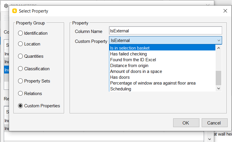

        [0_1604513270150_original-smc-api-info-examples-1.0.0.jar](Uploading 100%) Hi. This was actually changed in 9.12.0 on purpose (https://www.solibri.com/news/solibri-9-12-0-release-notes)
        What happens is that the possible previous results are not removed for those components that are no longer in the selection basket. The idea being that you are able to recheck certain components when changing parameterization and not losing the results for other components.
        One way to get the old behavior back would be to set current selection basket to the main component filter. But that is not so easy, it would have to be done manually. It can be achieved with custom infos (https://society.solibri.com/topic/563/information-api)
        We happen to have a property called “Is in selection basket” in our examples (https://github.com/Solibri/api-examples/blob/master/info-examples/src/main/java/com/solibri/smc/api/examples/IsInSelectionBasket.java)
        You can try the attached pre-built example property and see if that fits your workflow. Just choose that property in your component filter in the rule you want to recheck and check all instead if selected. Download the attached ZIP, extract the JAR file inside it to C:\Users\Public\Solibri\SOLIBRI\API and try it out.
