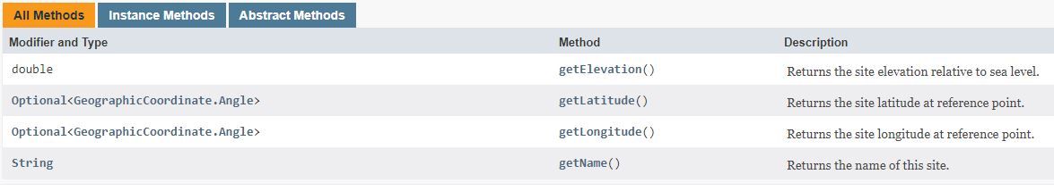

        Hi Lasse,
        Thank you for pointing out the link to the API documentation.
        I had a look at it and it seems that I can only retrieve some variables from the IfcSite through the API.
        This is what I’ve found:
        Is there any method to get the GrossFootprintArea parameter from the IfcSite?
        Thanks!
          lasse.lindqvist
          Some properties you need to use are likely inside property sets. They can be read with https://solibri.github.io/Developer-Platform/9.12.0/javadoc/com/solibri/smc/api/model/Component.html#getPropertySets() and then https://solibri.github.io/Developer-Platform/9.12.0/javadoc/com/solibri/smc/api/model/PropertySet.html#getProperty(java.lang.String)
          • M Offline
            M Offline
            mPiazziq
            Oh I see! It is a matter of ‘attributes’ vs. ‘properties’
            Thank you very much!
