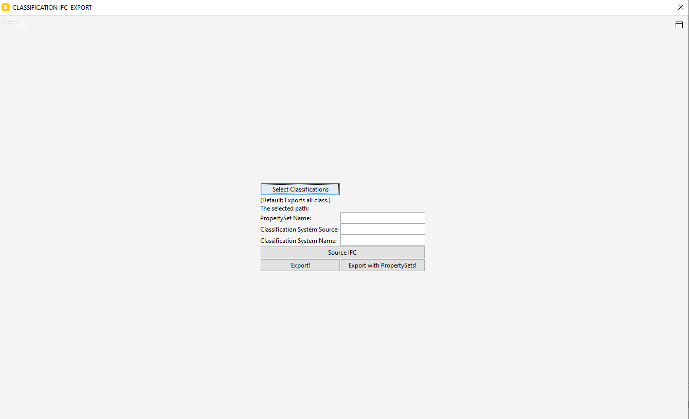

    @bim1337
    I had already tried to increase the window size, but it doesn’t work…
    B JeroenKoomenJ 2 Replies Last reply
    • M Offline
      M Offline
      Michael Enste
      Looks quite helpful and would be a great benefit. Unfortunatelly the file isn’t available at we-transfer anymore. Can anyone share it once again? Thanks.
      • B Offline
        B Offline
        BIM1337
        replied to BIM1337 on last edited by BIM1337
        @bim1337 said in Export Classification in Ifc:
        @jeroenkoomen said in Export Classification in Ifc:
        Do you mean this?
        https://www.linkedin.com/posts/daanarts_ifc-ifc-ugcPost-6879092239402967040-Pujb
        Just increase the window size worked for me.
        It shows up for me after selecting a Source IFC.

          • JeroenKoomenJ Offline
            JeroenKoomen
            replied to paola bronzo on last edited by
            @paola-bronzo
            Ik also tried it today but have the same problem…
            List of classifications does not show up…
            stretching the window tot full screen size does not help.
            not able to get this working…
            would be nice feature for Solibri to implement… can not be that difficult if it is possible to put it in a .jar file of 16kB

              • chrisC Offline
                chrisC Offline
                chris
                #11
                So far the plugin is a bit bugy but it worked with simple models very well. With larger models i couldn’t export the ifc (error). I assume, that the problem occur with complex geometries.
                @Solibrians Why not implement this functionality in Solibri as default? Export classification in Property Sets and IfcClassification Reference would be great.

                  @m-enste said in Export Classification in Ifc:
                  @bim1337 Thanks for sharing.
                  Credits to Daan Arts of course for sharing this on Linkedin, but no problem!
                  @chris said in Export Classification in Ifc:
                  Indeed to have this in Solibri would be great, although the plugin works fine.
                  I’ve exported on a decent Architectural IFC model that’s around 170mb, it worked but at first I thought it was freezing. The Solibri screen will remain frozen, for this model it was aprox 2.5 hours. But after that it completed the export, so large models will take quite a long time! But it does work, it doesn’t freeze without doing anything.
                  So after 2.5 hours Solibri will unfreeze and it’ll say export succesful.
                      @bim1337 I recognize that with frozen screen too. But i get an error message during re-import the IFC. File is damaged…
                      Hmmm, for me it worked on multiple IFC files, created in Revit ifc2x3.
                      Maybe it’s the ifc version?
                      chrisC 1 Reply Last reply

                        @bim1337 Ifc Files with complex geometries. CurtainWalls? Pipes? Profiles?
                          Idea to run the IFC through the IFC optimizer first?
                          Another program that I use is Simplebim, for re-exporting an IFC. This helps sometimes with buggy IFC models…
