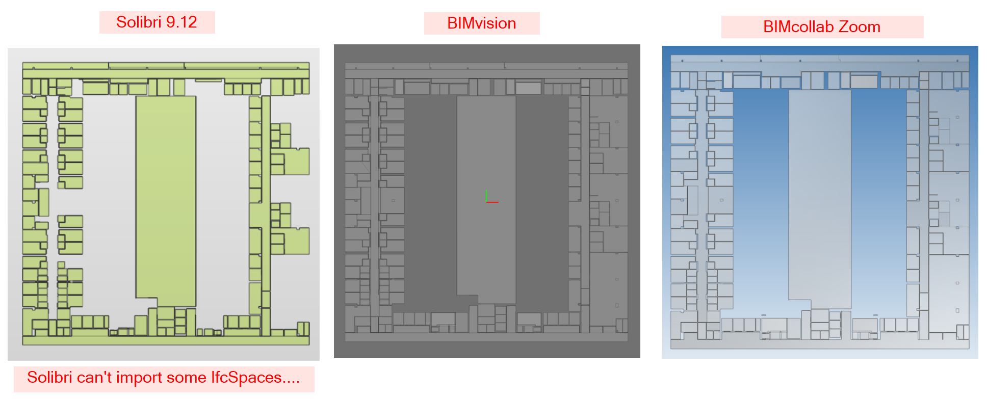

    Hi all,
    Solibri 9.12 has some problems to import some IfcSpaces.
    I attach:
    • an image comparing the same IFC opened in diferents softwares,
    • the IFC file.
    Kind regards,
    Xavier Coll
    EiPM
    201126_ARQ_IFC4_Spaces_LV05.ifc

              @nando said in Solibri can't import all IfcSpaces:
              smells like IFC4 issues (from experience). Have you tried getting the file in IFC2x3?
              • This file is invalid IFC4. The file uses IFCINDEXEDPOLYGONALFACEWITHVOIDS with void lists as (0), (0, 0), or (0, 0, 0).
              • IFC file generated by GRAPHISOFT ARCHICAD 23.0.0 SPA FULL Windows version (IFC add-on version: 3003 SPA FULL).
              • The last parameter in IFCINDEXEDPOLYGONALFACEWITHVOIDS is InnerCoordIndices
              • InnerCoordIndices is: Two-dimensional list, where the first dimension represents each inner loop (from 1 to N) and the second dimension the indices to three or more points that define the vertices of each inner loop. See: https://standards.buildingsmart.org/IFC/RELEASE/IFC4/ADD2_TC1/HTML/schema/ifcgeometricmodelresource/lexical/ifcindexedpolygonalfacewithvoids.htm
              #893 = IFCINDEXEDPOLYGONALFACEWITHVOIDS((10, 37, 38, 33, 32, 39, 40, 41, 42, 43, 44, 15, 14, 11), (0));
              #574 = IFCINDEXEDPOLYGONALFACEWITHVOIDS((44, 7, 6, 43, 45, 46, 47, 48, 49, 50, 51, 52, 53, 54, 55, 56), (0, 0));
              Should be reported to Graphisoft. They might already have a fix in update.
              A correct InnerCoordIndices with a single four corner void should look like:
              #893 = IFCINDEXEDPOLYGONALFACEWITHVOIDS((10, 37, 38, 33, 32, 39, 40, 41, 42, 43, 44, 15, 14, 11), ((11, 22, 33, 44));
