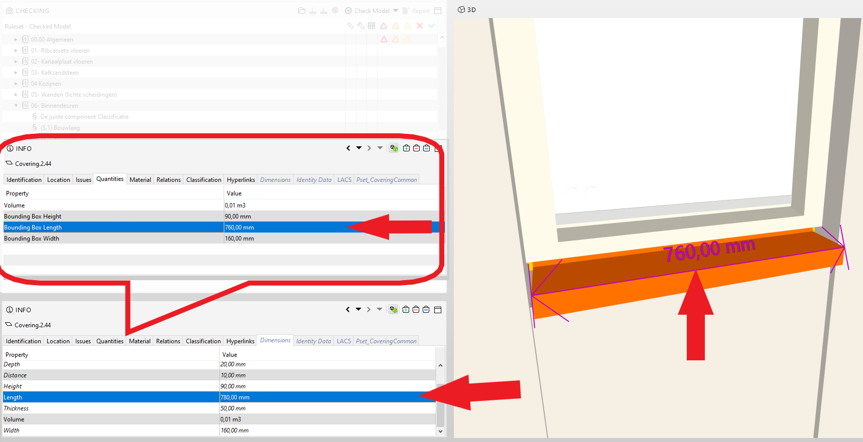

    We are working with Solibri and BIMcollabZOOM and I see different quantities in the components.
    For Example:
    When I select a component in Solibri I see in the quantities the bounding box length. In the other tab Dimensions I see the Length. These are different, and I see it is a gross/net quantity.
    But if I look in ZOOM, I see only quantities that are exported in the IFC and that’s only the Length.
    I am shocking to see that, because if I want to make list in ZOOM, I have the wrong lengths.
    So,… my question in this story is:
    • How do I know in Solibri the difference of the IFC dimension or the Solibri dimension.
    • And how can I check that the IFC dimension is correct, without making specific component rules.

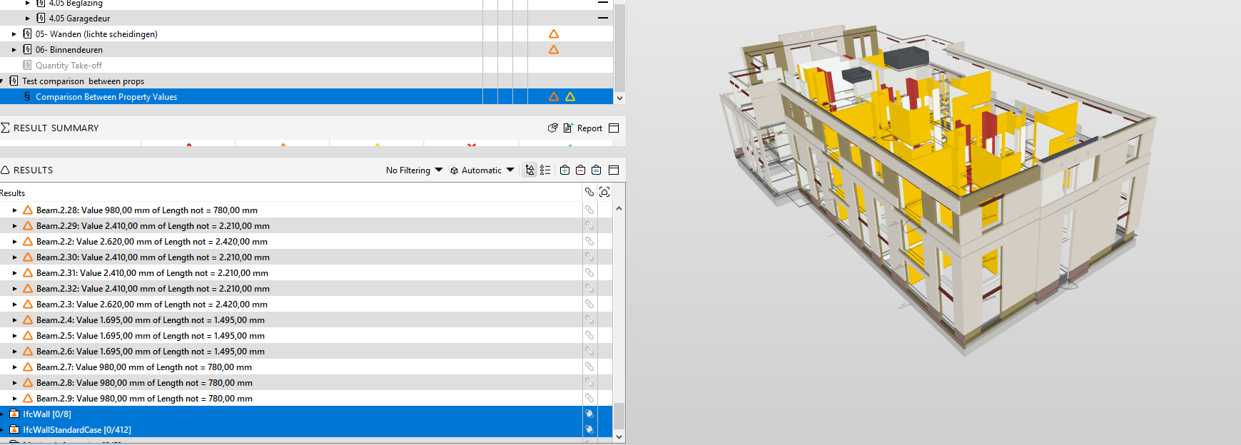

      • Create an ITO with Solibri and IFC dimesion column. See differences in Excel.
      • Create a rule that compares these two properties. Use rule template #231

          Propertysets that are black (for examples Quantities) are calculated by Solibri using the IFC geometry.
          Propertysets that are grey/lightblue and italic contain information exported by the modelling software. In this case the propertyset Dimensions.
          Both are not allways correct… so we put them side by side in a ITO. If there is a big difference then you know you have to investigate further…
