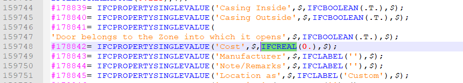

    does anyone know a way to check that the attributes have the correct “data type”?
    For example checking that the “Cost” Attribute is an IFCREAL and not an IFCTEXT.

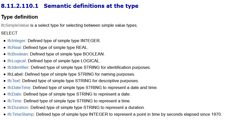

    Below the reference of the Building Smart page:
    https://standards.buildingsmart.org/IFC/RELEASE/IFC4/ADD2_TC1/HTML/schema/ifcmeasureresource/lexical/ifcsimplevalue.htm

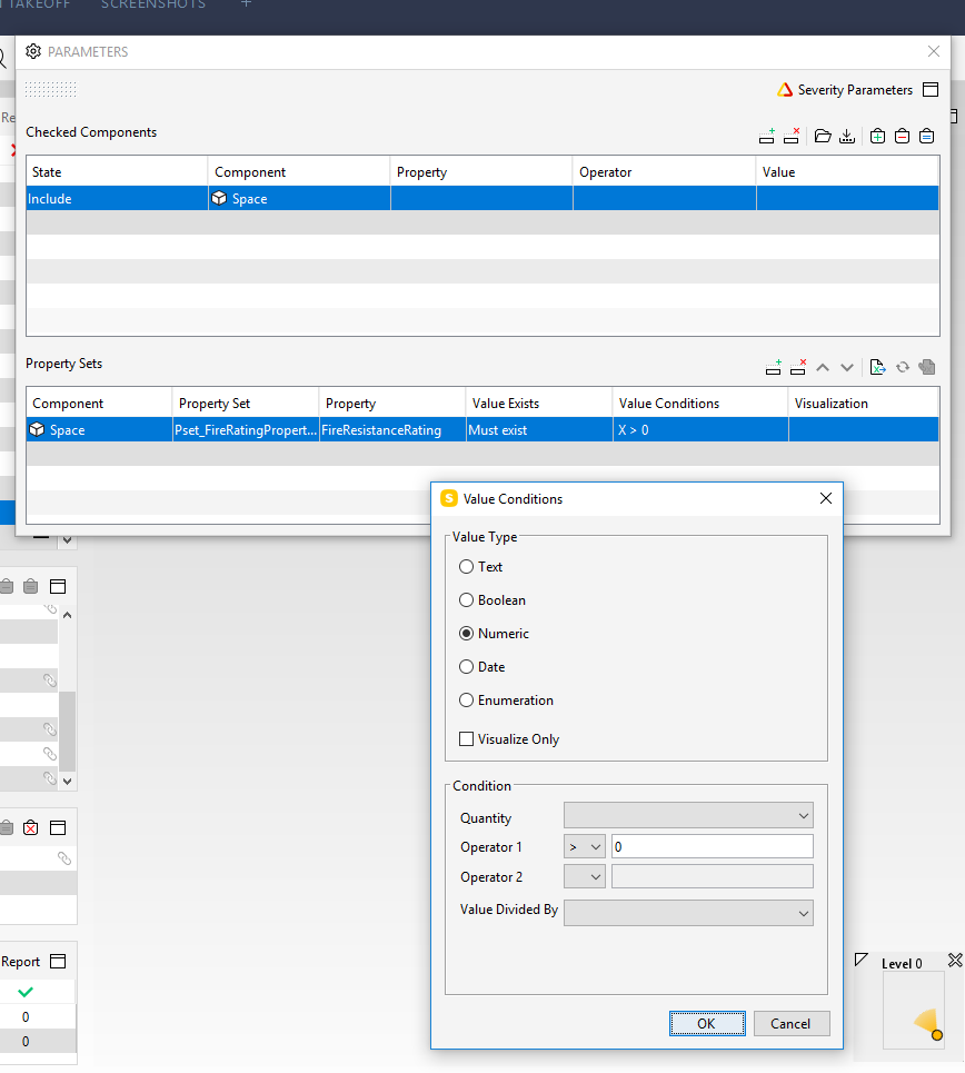

      My suggestion would be to use SOL/230/1.1 and to check if the Property Cost is a decimal value >0. All deviating values with letters or other characters should be reported as an error. In this case you should not care if that property is an IfcReal of IfcLabel, as long as the numbers fit

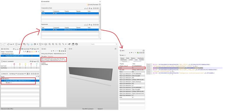

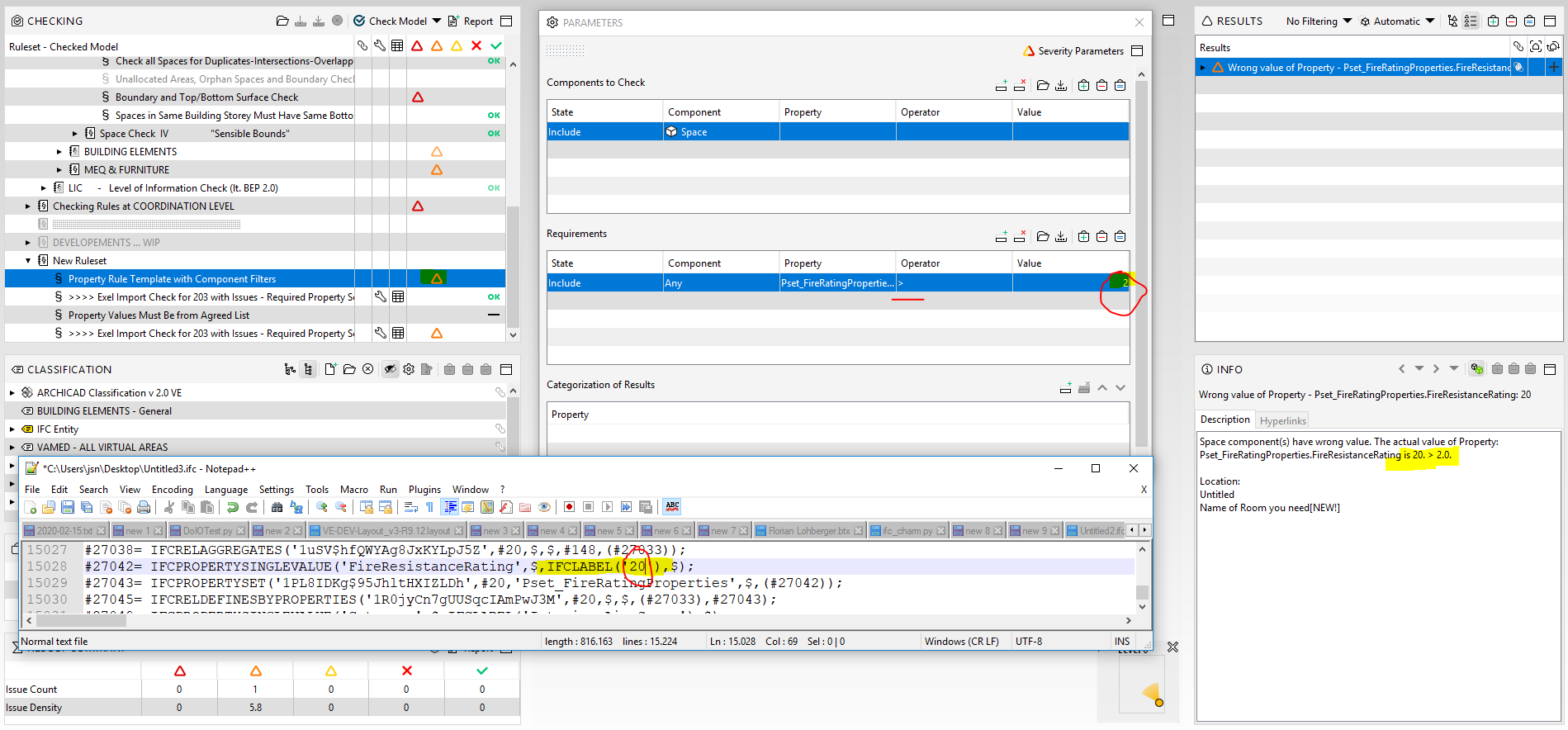

        I agree with you that it is not excluded that an Ifc Label for the CostProperty could be correct, but if I want to check the Cost is > 0 and the Bim Specialist assigns an attribute IfcLabel to the element when in Solibri I use the #230 or #203, checking will still report the error:

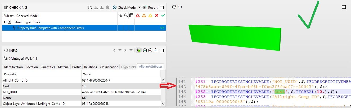

        the error does not appear if the attribute is exported correctly as a number:
        This shows that the rules secretly analyze the “defined type” attribute. It would be useful if it was also reported in the result’s description or or that there was a specially programmed rule.
          @paola-bronzo said in Defined Type Check:
          #230 is a diva and does not work sometimes - try it with #203 as it seems to be more robust and should work for labels too.
          However, take care that you really have a numeric vlaue like “200” and not "200 " with invisible blank spaces.
