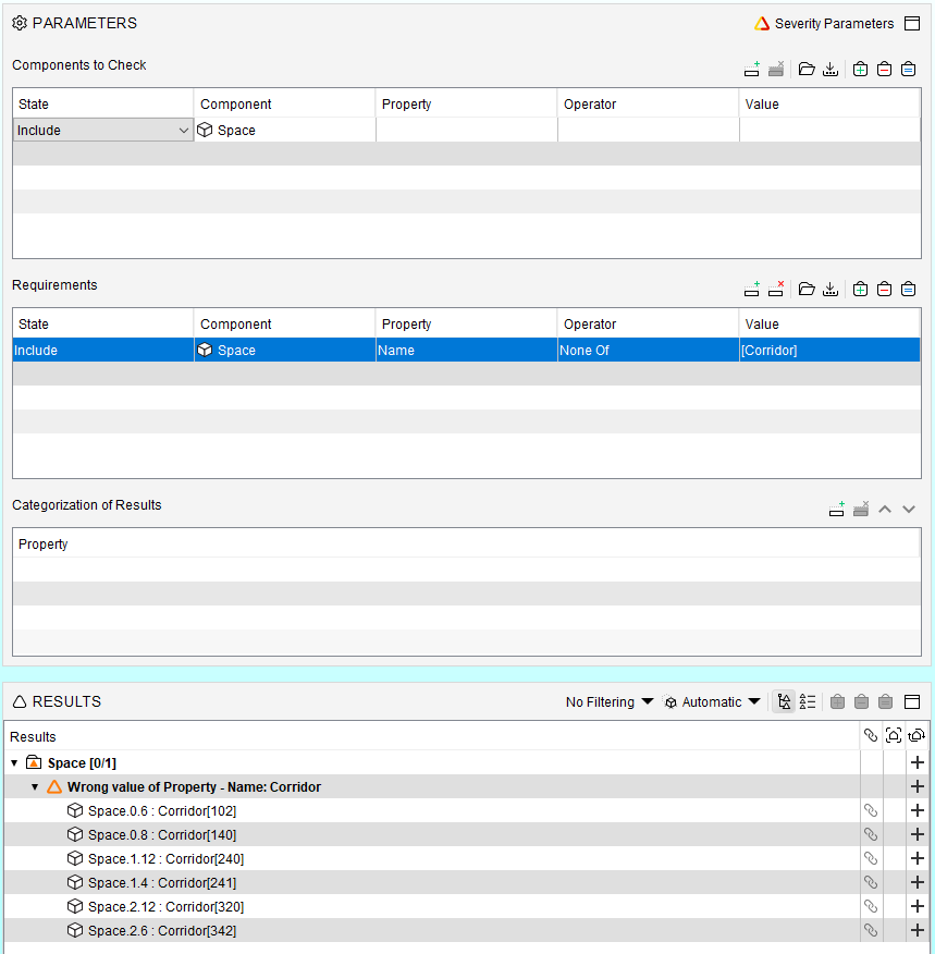

        @jsn said in Objects should not to be in the model:
        use SOL 230
        In some cases the rule #230 can be used without classifications.
        This example shows checking of invalid spaces:
