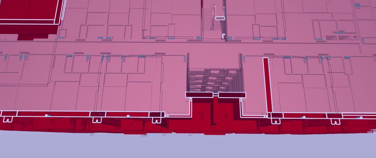

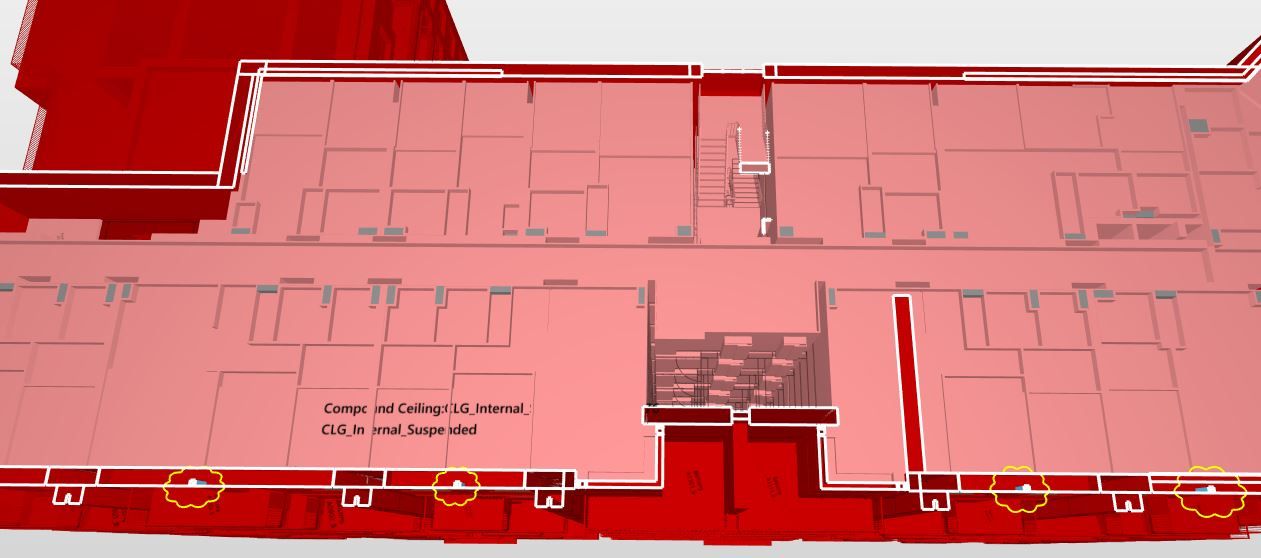

        lhoward
        I set up a view from the Checking Results, with the orientation and displayed elements that I need, the markups added to identify the clashes and the section plane switched off. When I add that to the BCF LIVE VIEW as an issue the markups all turn red and the section plane is switched on. If I select another issue and then go back to the newly created one the markups are still visible. However, if I then sync that issue with BIM Track and then reselect the issue in the BCF LIVE VIEW dialog, the markups have disappeared in the view window. They are still visible on the viewpoint in the LIVE ISSUES DETAILS dialog and they are the original colour. Also the issue uploaded to BIM Track looks as it should. The problem is that when the same issue is selected in the BCF LIVE VIEW dialog the result in the main view is no markups. Image from Checking Results.JPG Image from BCF LIVE VIEW dialog.JPG I have uploaded two images - one is the correct image from the checking results and the other is how it looks when selected in the BCF LIVE VIEW dialog
