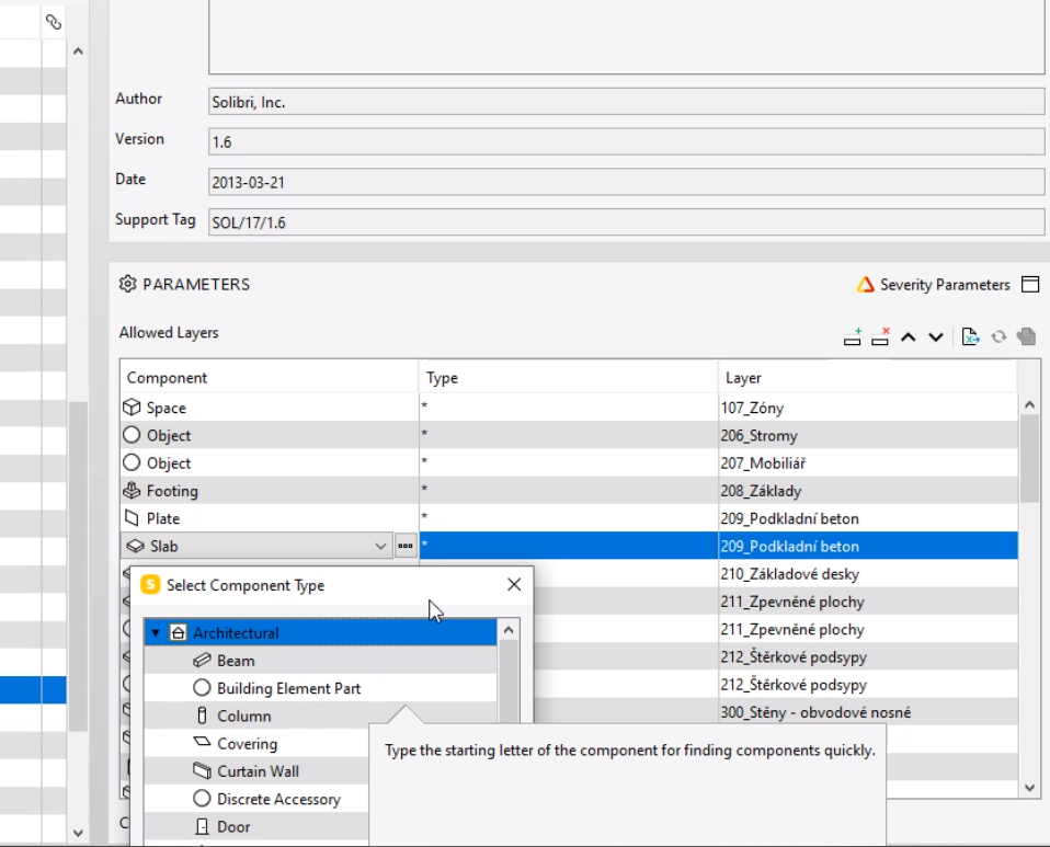

    I need to put * or “any” component into the row. Otherwise it will be too dramatic - write again for each component type the same layer = row.
    Is there the way to solve?

      You could probably use the excel export/import to speed up the setup workflow and just copy/paste the layer there if it’s the same? Regarding your wish, do you mean “any/*” of a discipline or how should it make sense in the end?
        Thanks a lot for reply. I use the excel. I want just to compare the layer names with prescripted layer names from BEP. I dont want to prescribe specific “component type” to each layer. I simply wanted to write * as it is possible in second column. Report of this rule tells me if the layer is missing in model or missing in BEP. But know I have to develop which component can be in which layer.
          Well, this ain’t gonna work with that rule as it validates elements and not layers. Furthermore if you put an asterix then this …
          … wouldn’t work either as you check all elements (which are on different layers I guess) at once and therefore you would kinda get a weird result as this rule just has been created for the opposite purpose.
          However you could probably use a different rule to achieve what you want. E.g. check all the layers of all elements with #230 and if there is no match you are informed.
