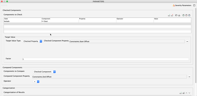

            simon.gilbert Solibrians
            Another method if the data is from Revit, simply export the constraints Start and End offset properties, then use the #231 Comparison between property values rule template.
            Configuration example can be seen below. In the example below for ducts if the two properties are equal to each other, they are horizontal, failures show anything other than horizontal. Just change this to pipes instead and then you can pass these elements to your particular rule using the subrule options.
