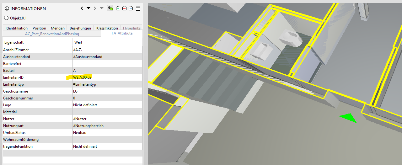

    I have modelled a 3D entrance arrow for each apartment, which is assigned the same Apartment number. This Parameter Einheiten-ID is shared by all Rooms which are belong to the same apartment.
    Now I would like to check if all the rooms which are near this entrance arrow have the same value for Einheiten-ID. I have been trying with SOL/222 but I am having no success.

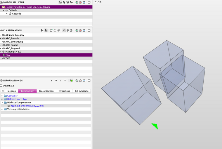

              If you still want to solve it the other way: It would be great, if your example file could also contain walls an doors for this flat. There are relations that could help with your question, in this screenshot, the arrow shows a relation to the living room. I guess the relation to the entrance door could be even more specific:

                  Ok I see what you mean now, in the file which actually contains the building elements the Arrow has only a relation to the Stairwell room as it is placed in this room but only points the the aparment it represents und shares just the one Attribute.
