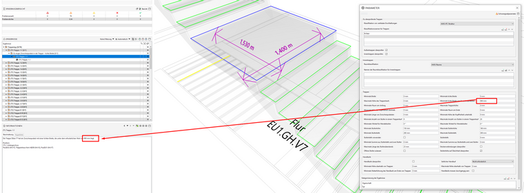

    can anyone help me and explain why the stair does not fulfill the size of the landing?
    The ruleset is set to 900mm and the landing is much bigger than that…
    I actually get for all the stairs the same problem!
    Any clues?

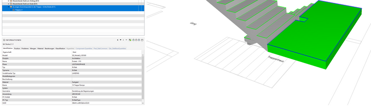

      Often (normally?) the landings are ifcSlab. Maybe the rule checks only ifcSlab within a ifcStair and your landing does have a different entity or the stair is not an assembly.
      Just an initial guess

        thanks @hkringsKUBUS bus sadly was not the case.
        You are correct that the middle landing is an IfcSlab Type LANDING, which is also in my case:
        Even solibri detects this part of the object as a landing, because in the error message (first post) he mentions the “Zwischenpodest” (ger. stair landing). It does not matter if the geometry of the landing is just rectangular or not, he cannot find the correct dimensions of it, hence resulting in an error.
        Does anyone else experience the same problem?
        @Solibrians are we dealing here with a bug?
