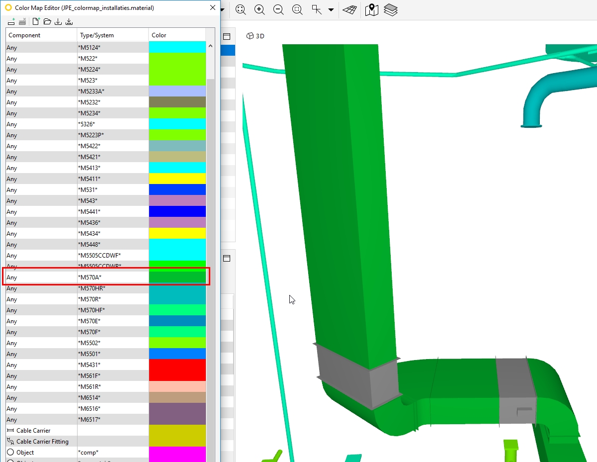

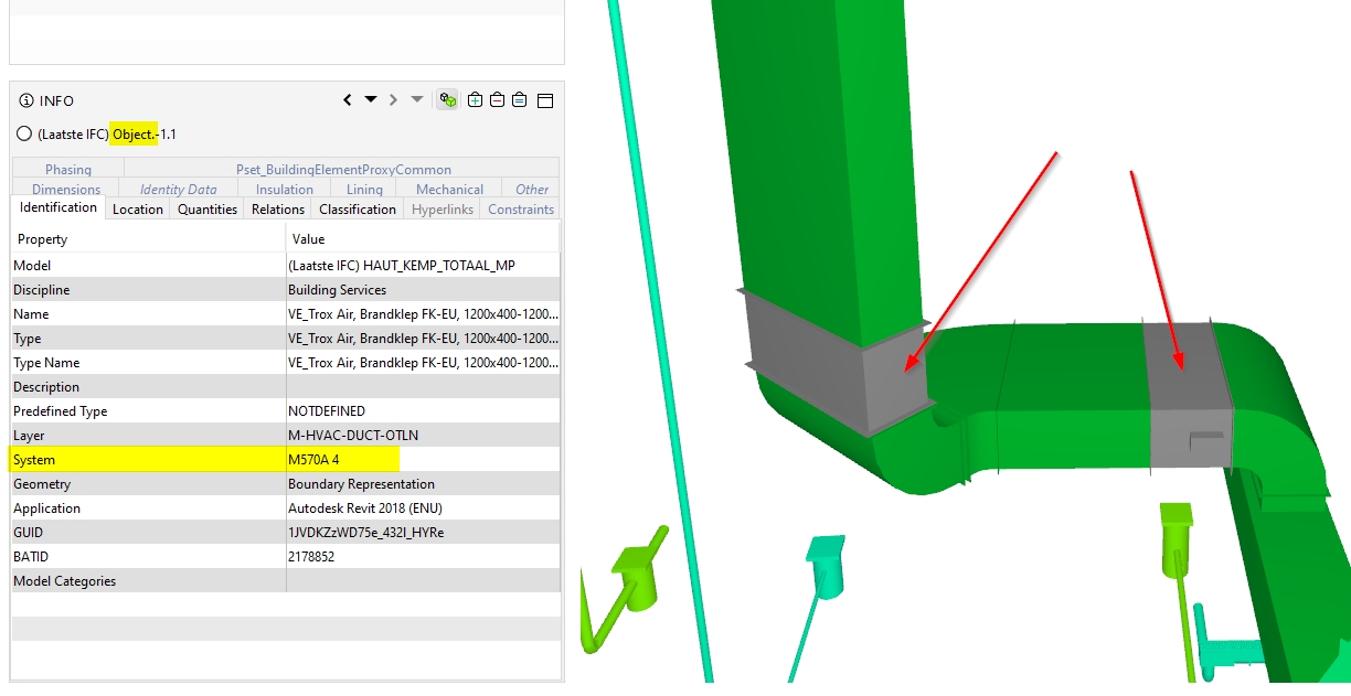

    When coloring installatation models, somtimes not all elemnets are colored. This happens mostly with elements with the entity: object.
    Here a view of the colored model with two objects not colored.
    Below the colortable:
