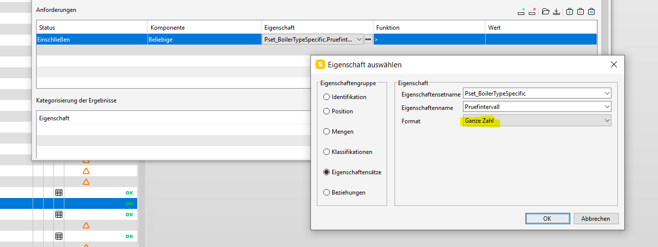

    I want to check the following Integer type value of a property, let’s say the following one …
    However, I have problems with SOL 230 as if I make my selection …
    … it simply does not allow me to confirm the desired values e.g." > 0".
    So it gets stuck and if I close and reopen there is no value (!) which leads to a completion of the rule without any hint (!) or it simply jumps back to an old value. What is going on here?

        Here it is definitely an Integer type.
        Anyhow I try to avoid 230 as 203 is the much better way to follow if you want to have a working rule. Plus, changes can be applied more userfriendly as it does not delete the entire line if you change something …
        Although I still do not know what is the secret symbol for a numeric no unit comparison import … https://society.solibri.com/topic/1116/import-excel-worksheet-rule-203/12?_=1619534106834
        Maybe one day Solibri will tell us or even publish some cheatsheets …

          Pretty sure this is some sort of bug.
          Also working in German and hte integer doesn’t seem to be recognized.
          Will try exporting as a double to see if it is recognized

            Well, it is as I expected…
            For some reason, the integers are not working. Maybe this has something to do with the German version?
            For the time being, I simply used a text to get what I needed to work (working with variables of 0, 1 and 2.)
            I didn’t play around with length that much…but I suppose that would be the only other possible option to use operators. “Real” Numbers also didn’t seem to work.
