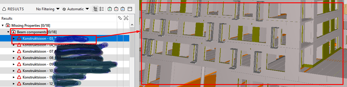

    I created a rule based on SOL/203/2.4 where I want to check that components have particular property sets and those property sets have particular parameters/properties.
    The rule itself works good but I have a question about visualization of the results.
    For example, I want to check that beams in the model have all 20 necessary parameters.
    Solibri shows that there are some missing properties and it also shows the list of missing properties. But when I click on the “Konstruktsioon - 03…” it does not show me only the beams which are missing properties, but it shows me the whole structural model.
    But I would like to see in the 3D view only the componens that are missing some properties, e.g. if all the beams are missing property “Konstruktsioon - 03…”, I would like to see only those beams in the view.
    That is why I would like to know is it possible to achieve that somehow? Or is it Solibri limitation and that is not possible?
    Thanks in advance!

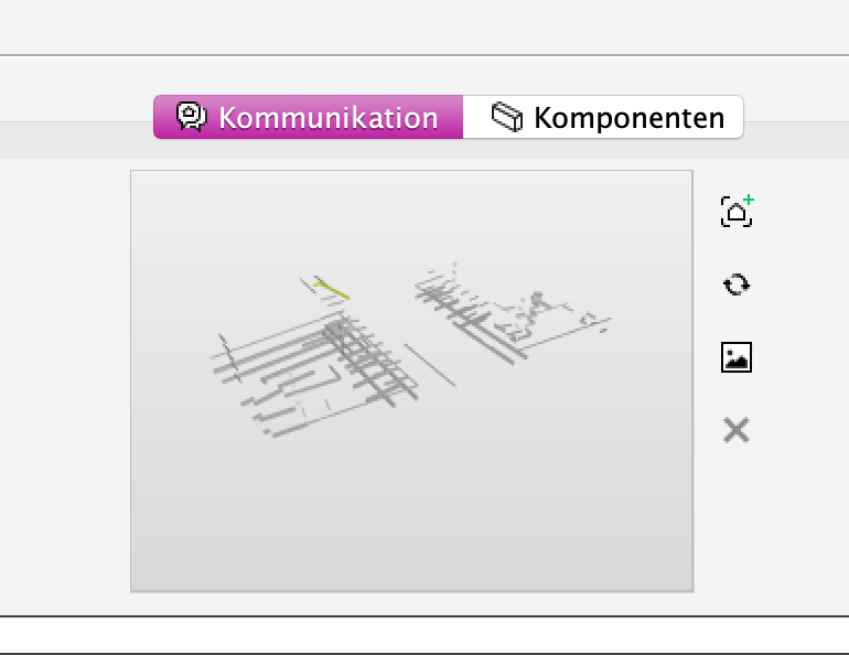

        If you want to create an issue with the elements, (1) select all the beams in the selection basket:
        (2) Click on the problem and then create an issue. Then you will have the elements in question visible.

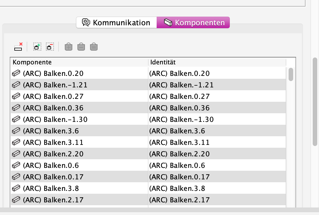

        (3) In addition, you can manually add the beams from the selection basket to the component list.

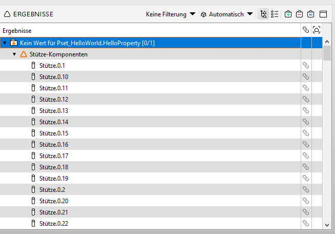

          1) Rule #203
          If you use 203 and the whole Pset is missing, then you do not get this error on element level but just for the whole building as we know already.
          E.g. All 123 columns in my project are missing several properties - as the pset is not exisiting - then I get just one error > which is actually not reflecting the truth.

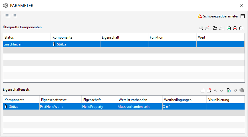

            The componentn filter is actually just setup to check for 1 element (an object).
            However due to the nature of 203 the error gets tracked on the IfcBuiling level - which is not good for tracking real issue numbers.
            But not enough, actually the number in the summary report is also totally wrong, as it ignores the component filter completely and gives you the number of all (of the same) component in the whole file - as long as there isn’t such a property in another model.
