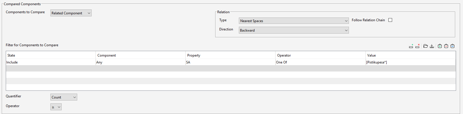

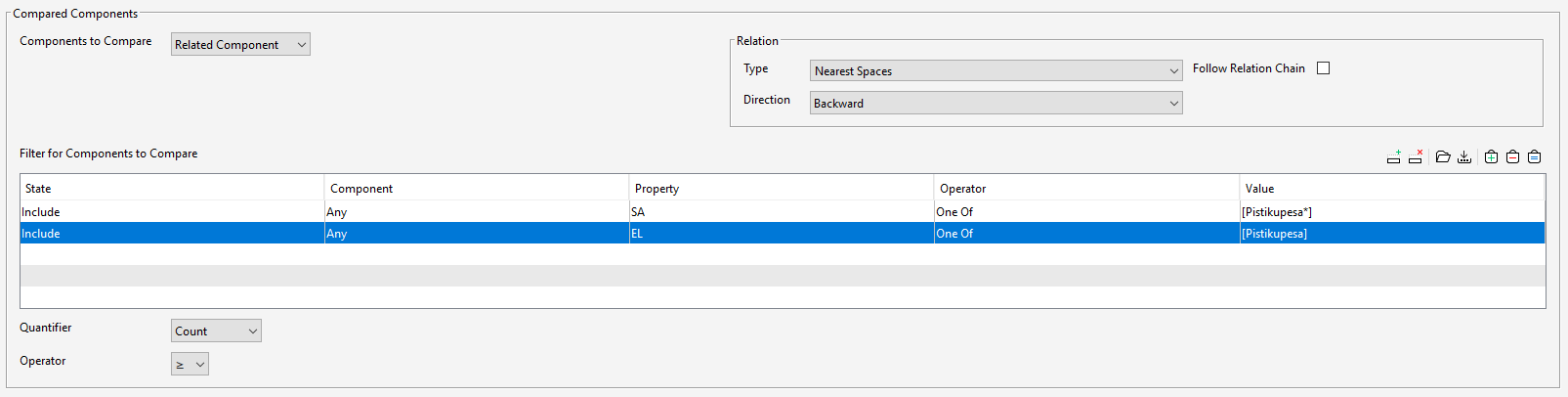

    Is this a bug of rule SOL/231/1.6 or I am using it wrong? When I use one row in Filter for Components to Compare everything is working, if I add second row I get no elements if I press button Set to Selection Basket. I am using different Classification properties.
    Elements will be in Selection Basket
    No elements in Selection Basket

        @lraimo , when you filter elements you need to take into account that it filters the rules per rows in an ‘AND’ statement instead of ‘OR’ so what you’re saying is:
        1. select any component with certain properties in row 1
        2. starting from the selection you already made in row one, now you’ll filter this primary selection and filter that they also need to have the second filter row as a rule
        I hope I’ve made myself clear because it’s not so easy to explain. You can solve it though by using the exclude option
        First you select any without any rules/properties and then you exclude the ones you don’t want:
        https://solibri-community.force.com/know2/s/article/UUID-a90c2211-2dca-acf1-3055-4ebcc3b005ed
