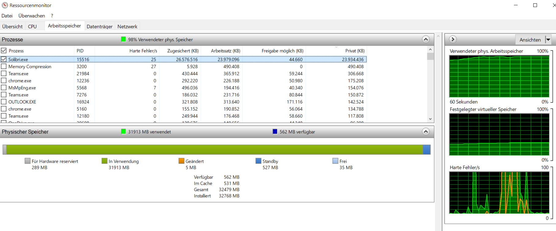

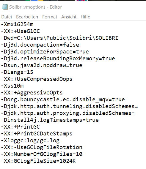

          of course I´m using Solibri 9.10.8.34.
          The RAM capacity of my Laptop:
          And in the file “Solibri.vmoptions”:
          I don´t now if the Solibri.vmoption file really defines my RAM usage because when solibri is running with the big project file the RAM sometime is nearly fully occupied only through Solibri:
          Thanks for the help

                    @hechtwiefisch
                    Might be the same bug that was discussed in the Solibri internal chat.
                    Try adding the following to VMOptions file:
                    -Djava.util.Arrays.useLegacyMergeSort=true
                    HechtwieFischH 2 Replies Last reply
