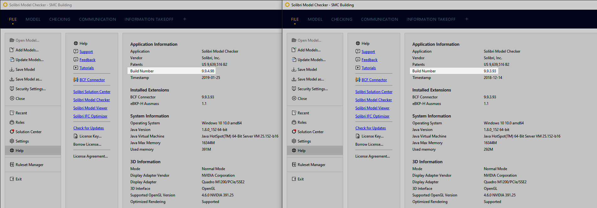

    For an explenation of the oncoming screenshot, on the left side, SMC v9.9.4.98 is opened whereas on the right side, the result-view of SMC v9.9.3.93 will be displayed.

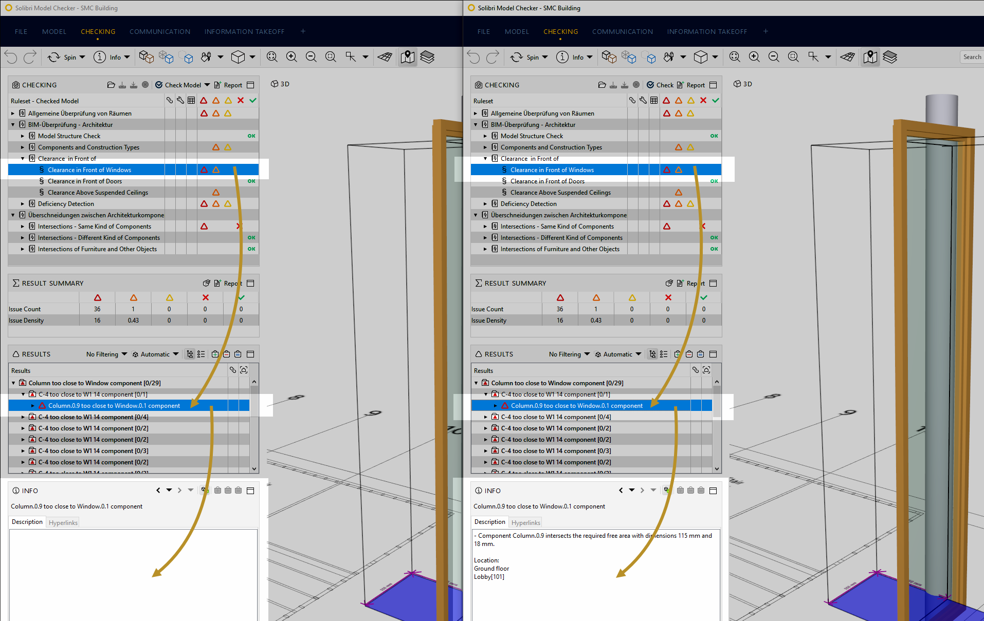

    I opened the SMC standard project, the “SMC Building”, and gave it a shot with the standard ruleset. Amongst other things, there was the check for clearance in front of objects. So after checking the model with those rules, i clicked onto these results.
    As it seems to work perfectly fine in the v9.9.3.93, there are no information displayed in the newest version of SMC whatsoever. This doesn’t seem to occur in all of the results, but it does in the standard rule “Clearance in Front of Windows”, or “Clearance in Front of Doors” for example. At least it does in my case. 🤔
    Has anybody noticed something like that as well? I already de- and reinstalled the SMC to be sure the rulesets aren’t modified in any way.

      @Nicola-Tessarolo Hi! indeed, this is already reported by support and waiting for a fix. 🙂
