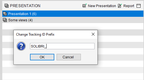

    I don’t understand how to use the Presentation Prefix. I can set it up, but then I see it nowhere. The help states:
    If you wish, give the presentation a prefix. Prefix of a presentation is used to differentiate issues between presentations. It can be any alphanumeric string; the system automatically appends a unique number to issues in the presentation.**
    Where is this visible? What is it meant with “Differentiate issues between presentations”?
    … still trying to figure out how to organize issues in a large project.
    c
    MattiM 1 Reply Last reply
      replied to _c_ on last edited by
      @_c_ said in Where are the Presentation Prefixes?:

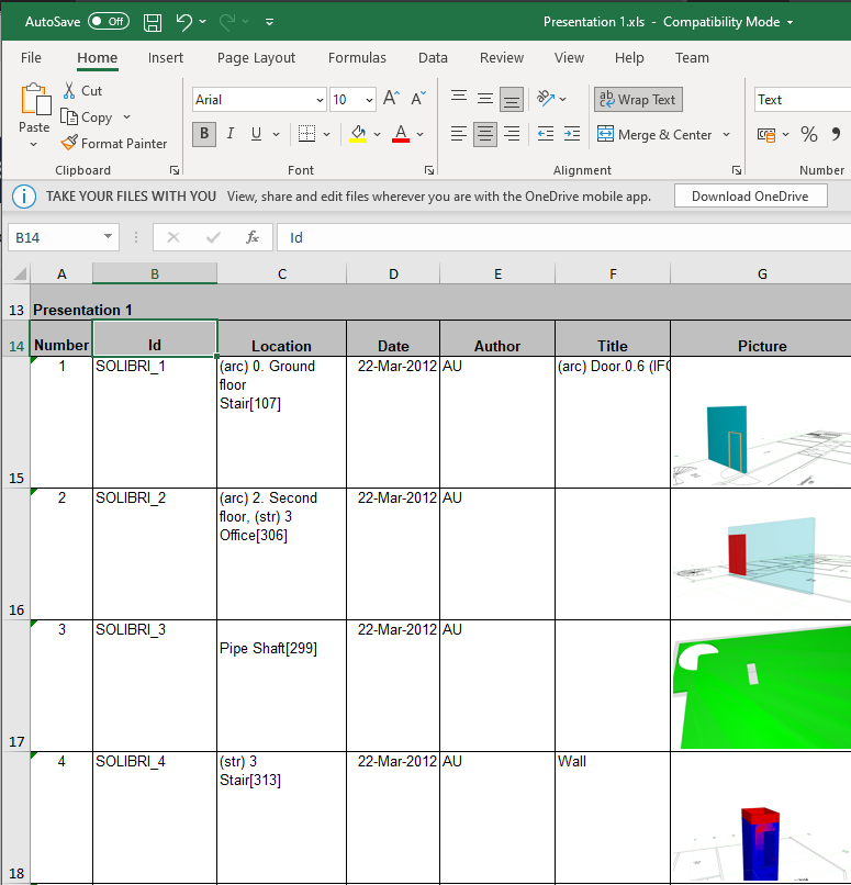

      I hope the pictures will help. There will be autogenerated tracking ID which can be different in each presentation.

        The tracking ID is always and forever incremental, isn’t it? Is not overwritten upon re-running rules?
          • Tracking ID = PREFIX + NUMBER.
          • Tracking ID is not overwritten.
          • The NUMBER is unique in the model, incremental, starting from 1.
          • NOTE: Tracking ID is not in BCF standard
