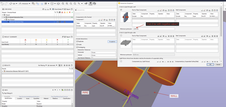

    Hi everyone!
    Coud anyone help me with Intersection Exceptions?
    I have situation when pipe hasn’t any protrusion above other side of wall and ending inside the wall. So, ever if i change the value of protrusion to zero, I have an issue in results.
    I try to change value to negative values and have the same results with issues.
    How can i avoid this? Thank you.

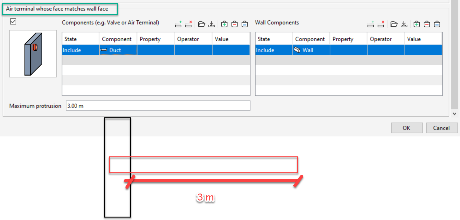

      Hello @Zeraxel !
      You could try the last exception option to exclude ducts that are not fully going through the wall, like this:
      Hope this works,
      Lauri/Solibri
