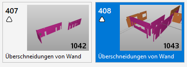

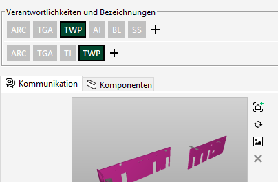

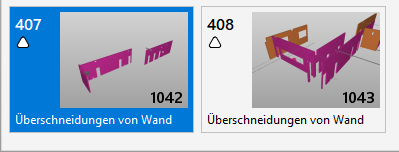

    A) If I mark one slide …
    … I get the following values.
    B) If I mark another slide
    … I get this values as well as I have assigned them here as well.

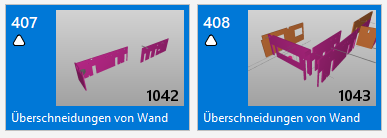

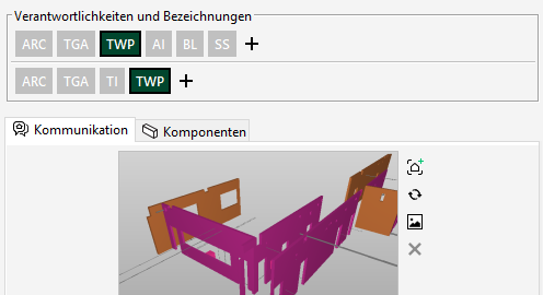

    C) However if I mark them now at the same time, then I get this?
    Multi editing slides does not speed up if it has this irritating behaviour.
