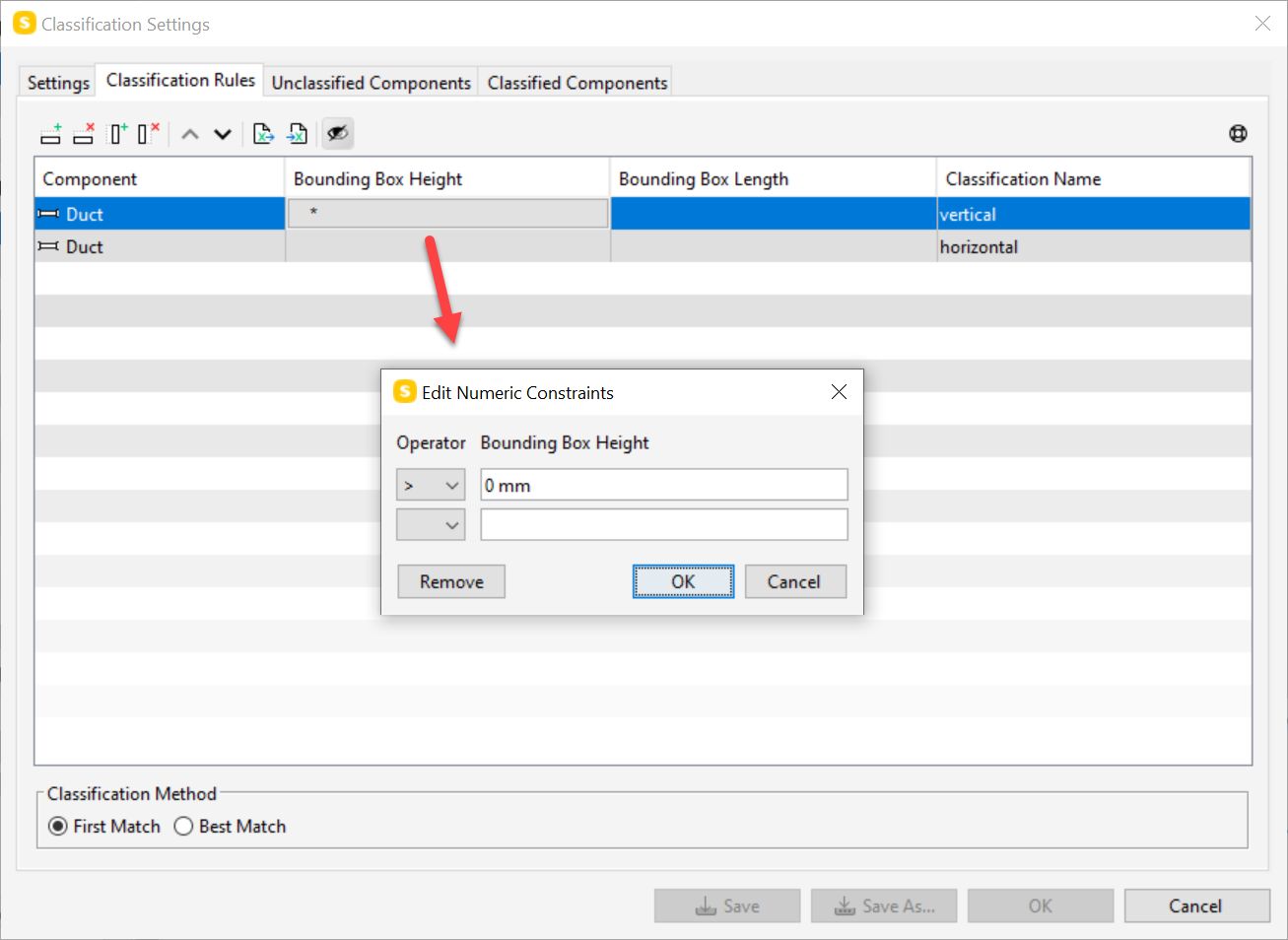

      Hi @pejotu ,
      Have you tried using classification to do this? There it is also possible to use the bounding box dimensions:
      ideally this information would come from the authoring tool but unfortunately that is rarely the case. Also if you have the duct size exported under some property set this can be useful when comparing to the bounding box dimensions.
      Anyways, we need to check in more detail how the rule behaves in the situation you described with the units.
