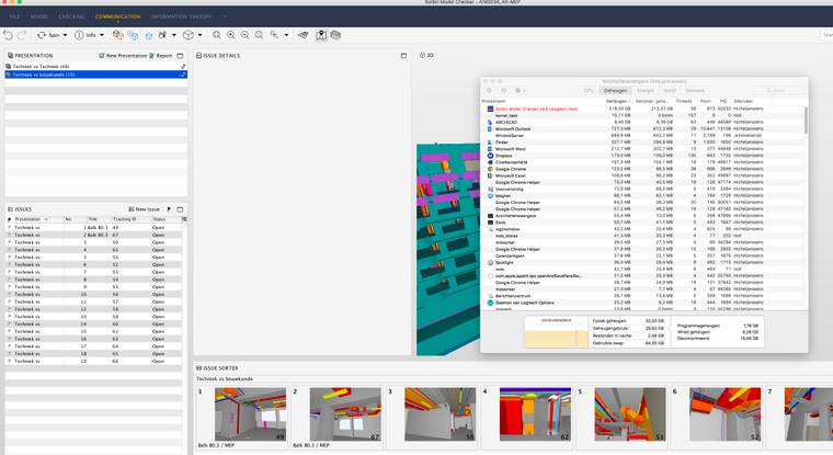

    We currently are working in Solibri on OS (Imacs and mac books pros).
    Since the release of version 9.8 (!), when making presentations of the checked issues, we encounter a bug when (double) clicking on a slide in the Issue Sorter.
    Solibri freezes and the amount of RAM that’s being used by Solibri rises quickly. If we don’t force quit the entire computer freezes.
    Are there any users who also encounter this problem (on a mac platform)?
    We don’t encouter this on a PC platform (same projects, same version of Solibri).

      Hi there, for weeks I had performance issues and freezes with my new MacBook (macOS Catalina) running SOLIBRI Office in version 9.10.6 and further on. Even the Update installer freezes. I want you to know that for me after quitting an now deinstalling the “Magnet” Window Manager systemextension, Solibri runs perfect (stable an fast). Hope that helps other Macbook users with comparable problems.

        Seems that this program causes the problem: https://itunes.apple.com/nl/app/magnet/id441258766?mt=12
        When Magnet is installed on your computer you should click 'ignore “program” when opening Solibri.
