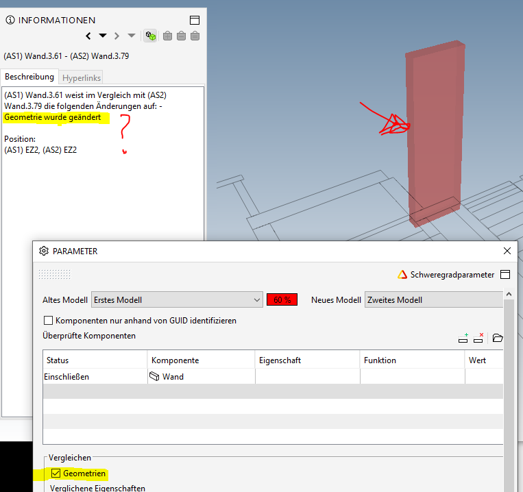

    Hello,
    I am using the rule 206 for checking model differences. If I enable “geometry” I have a lot of false positives where I don’t see any change. The report states only “geometry changed”, but doesn’t say what exactly.
    How can I exclude these? They ruin Autorun’s efficiency.
    c

      @_c_
      In the rule you can also define the report.
      There stand Component/Type/Location ‘on’.
      So the geometry isn’t changed, but for example the type
