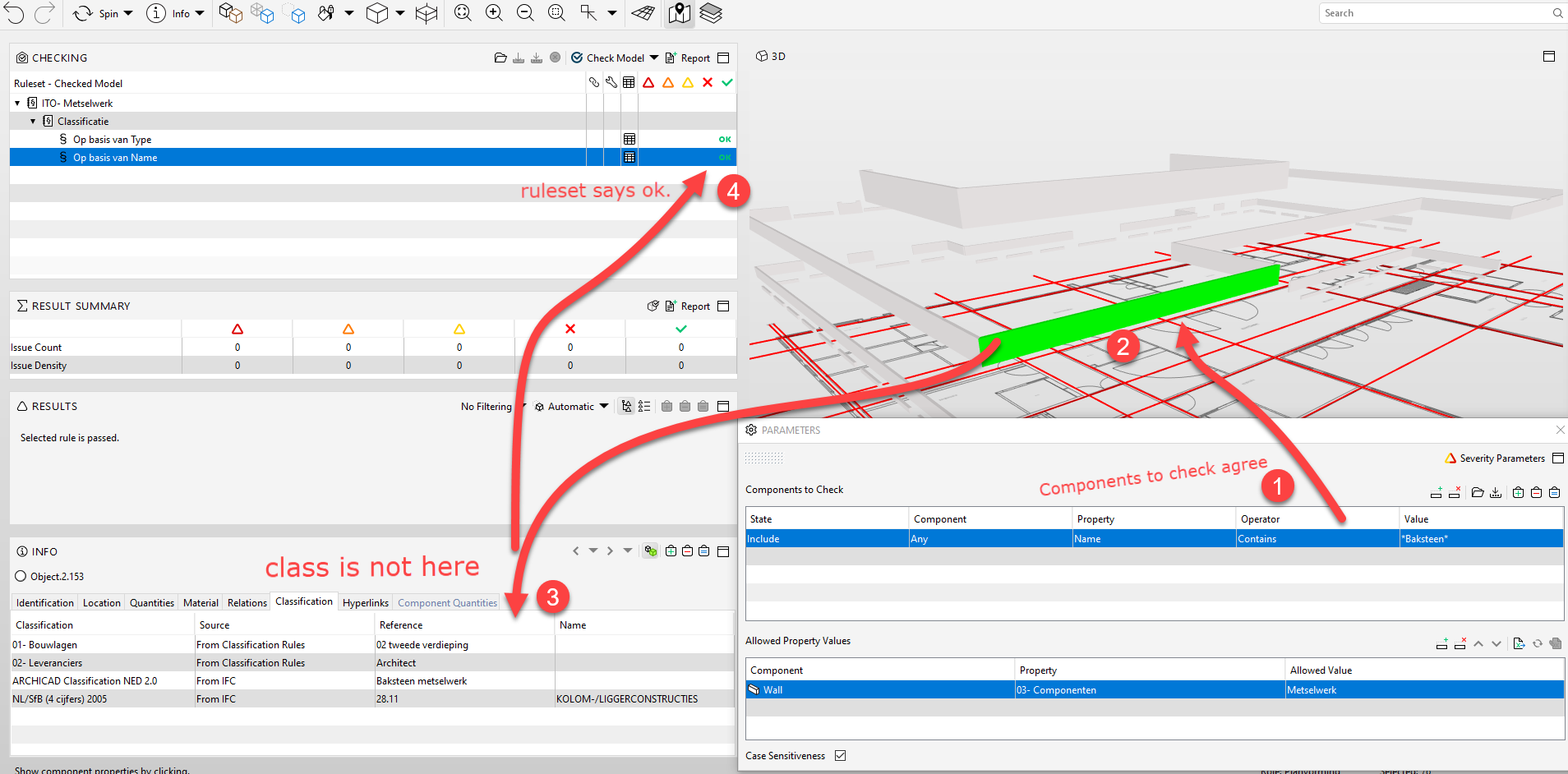

Rule 9/3.1 --> what did I wrong?
I used the role 9/3.1 to check if all components with bricks used in the classification.
The results in the rol is ‘ok’ , but it is not!
What is giong wrong here? -

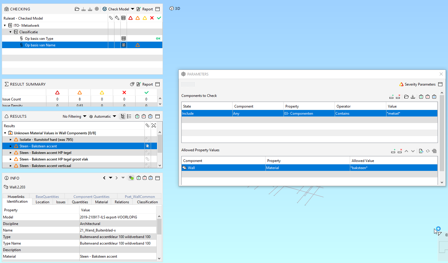

@sander-Eikelboom
What if you fill in the classification as the property, and the allowed property the material “baksteen”

@Harmen-Jorritsma , I have solibri 9.12, but its not a gatekeeper.
@BvanDalsum, If I fill in the de classification as a property, the rule works, but it is not result I want.The problem in this case is that we have a classification ‘metselwerk’ (brickworks) and with this classification we generate a Information takeoff.
Last weak we discovered a difference in the ITO and the manual calculation. After some searching we saw that the classification was not full with ‘metselwerk’.
So after that we make a checking rule. This checking rule is for all architects. And we see a lot of names for metselwerk.Anyway, in the maintime I used another ruleset (230). And I and I reported to our retailer (kubus Netherlands).

@sander-Eikelboom I send you a response to your e-mail on why the rule is not working.
Summary for whom is interested: With the original setup none components were checked. I looked like rule 9 requires a component match for both Components to Check and Allowed Property values.
In this specific case is therefore the solution to add a row to the allowed property values for the component type “object”.
