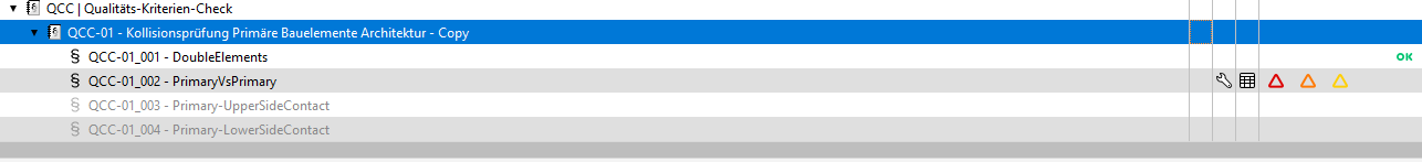

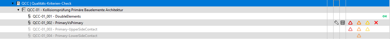

    This is my file before I update:
    After updating a model (almost identical, classifications are still working, …) and checking again the results dissapper and there is just … nothing in the active rules and checking process is finishing very quickly.
    However if i copy the ruleset it works (without changing anything) - needless to say that all my result connections are gone when I do this, so not really an option.
    Tried it a few times - not even closing and opening the ruleset helps me here, only if I copy or recreate the ruleset - it is everytime the same, what is going on here?!
