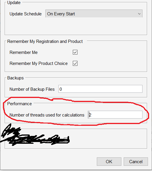

Hi. You should check Windows Task manager and what it shows for your CPU consumption while the checking is in action. Then if the CPU usage is really high, also check your Performance settings under General and make sure you are not assigning too many threads there, if you are assigning more than the amount of CPUs your machine has, you will want to decrease the amount so that it leaves some available for other things than the checking.
