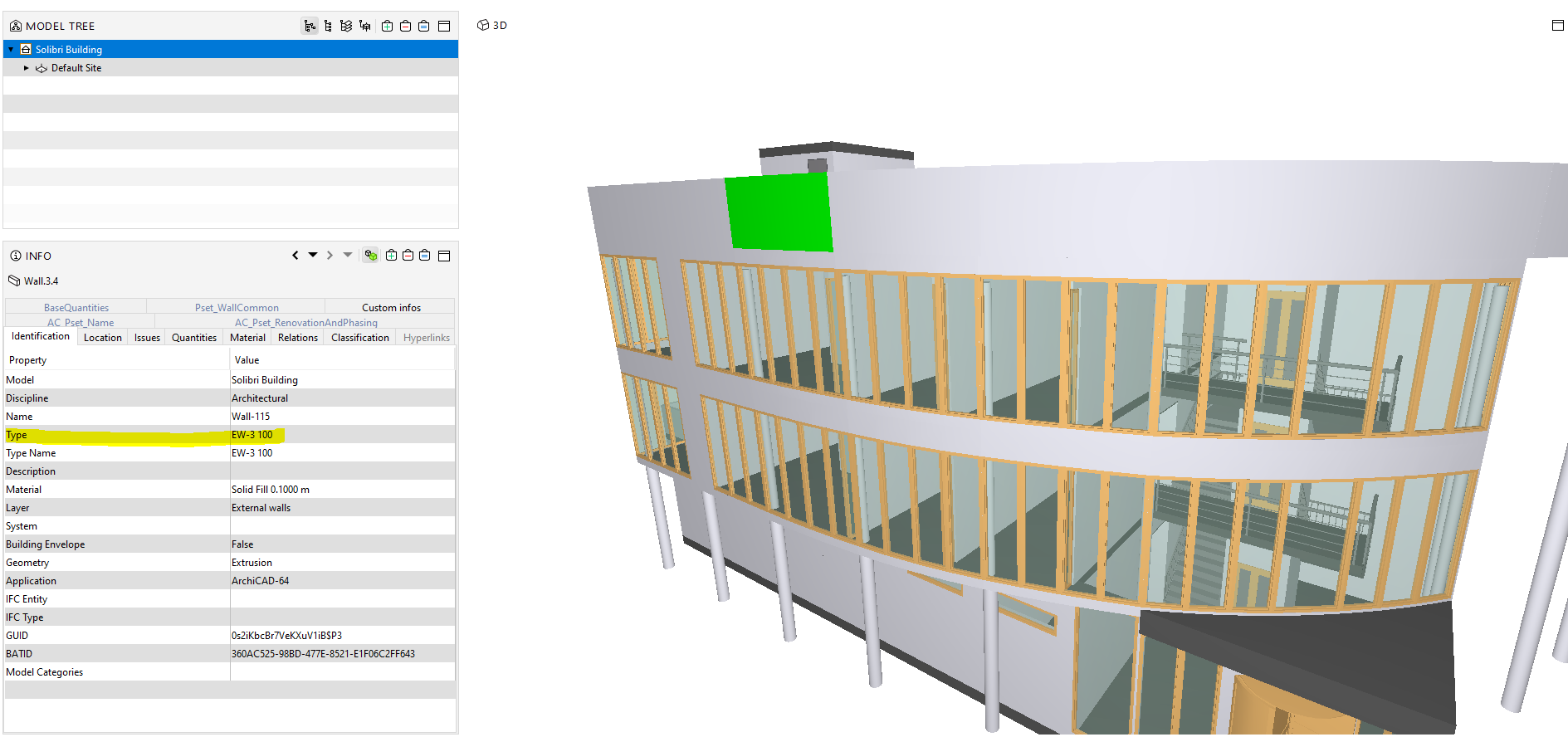

      @karlf Do you mean the ElementType?
      Type and TypeName are shown in Solibri and ZOOM. It is not always clear from where the Software take this information in the Ifc-Scheme.

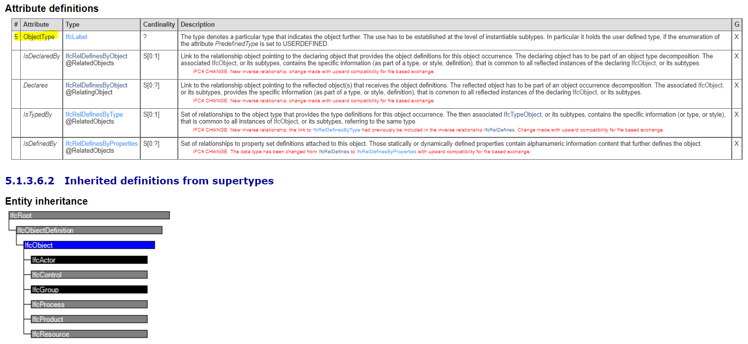

        Could you give an example for IfcObjectType? As such it doesn’t exist in the IFC Schema, but I can imagine that it can be various things, as the term type is used in various places:
        • an entity can be linked with a relation (IsTypedBy) with an IfcType which specifies characteristics for multiple entities. An example taken from Solibri Building.ifc:
        #376958= IFCWALLTYPE('1pfXAbp$yZdlNqlOCVMxbW',#15,'EW-3 100',$,$,$,$,
        '73A612A5-CFFF-239E-F5F4-BD831F5BB960',$,.NOTDEFINED.);
        As @chris was already writing, this can be found in Solibri here:
        • the attribute “ObjectType” (introduced with IfcObject) :
        denotes a particular type that indicates the object further. The use has to be established at the level of instantiable subtypes. In particular, it holds the user-defined type, if the enumeration of the attribute PredefinedType is set to USERDEFINED.
        There are also other options as IFC has many ways to represent these things … So if you can give a specific example we should be able to find what you are looking for 🙂

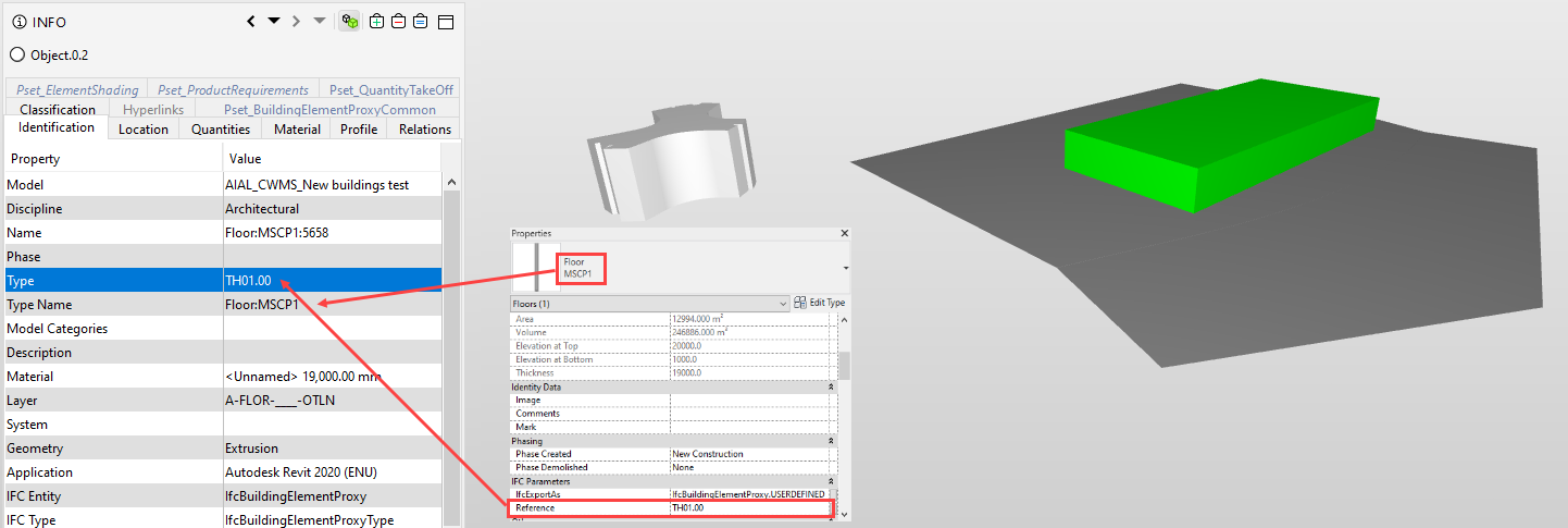

          @cpreidel Thank you for the detailed response. It clears things up. About 5 minutes after posting I had realised what info was going where. I typically use Archicad and understand the flow of data from there, but Revit is a different beast.
          In regards to the IfcObjectType, it was something I read about in the new Autodesk IFC guide and I was then testing out a workflow to see if it could be used as an attribute field to map a Project ID to a building mass (I am simply wanting to have each of our work packages as building masses, and need to be able to identify independently by project code).
          But once I worked out what was going where from Revit, I decided to create a shared parameter for ‘reference’ and override the default. So ended up with what you see in the image.
          Now I will put the ifc to GIS and use the type reference to link data inputted via GIS web app to the building masses.
