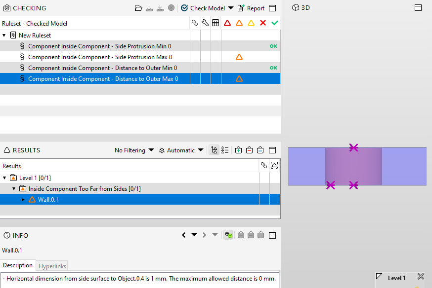

    I am using rule 234 to check if the ProvisionForVoids are fitting completely in the walls.
    It is showing me that the PFV is outside the wall 1 mm, but it doesn’t show that it is missing 1 mm from the inner side of the wall

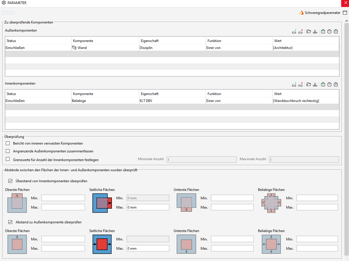

    Here is a screenshot of the rule parameter.
    Is there something I need to modify in the rule parameter to get it right?
    Thanks for your help!

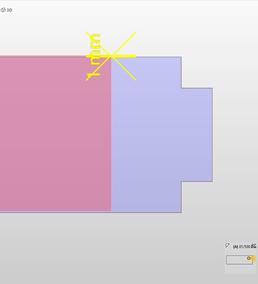

          I believe this is by design as you are hoping to check that both ends of the PoV touch the surface of the wall.
          The rule will fail only if no side is within 1mm of the surface. If the inside component (PoV) runs past and protrudes past or any side touches any surface of the wall, the rule passes the check for Distance to Outer Max.
          In order to fail, neither sides of void would need to be 1mm or more from the surface of the wall. Below, this wall has a PoV that is inside 1mm from both surfaces.
          Is this what you are looking for?
