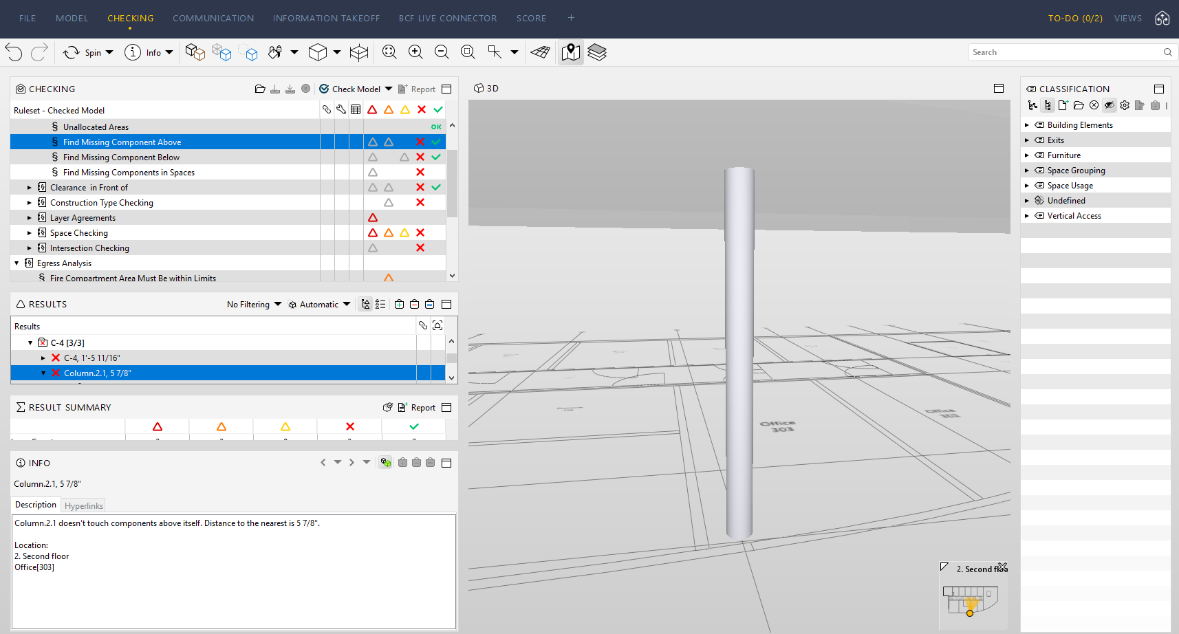

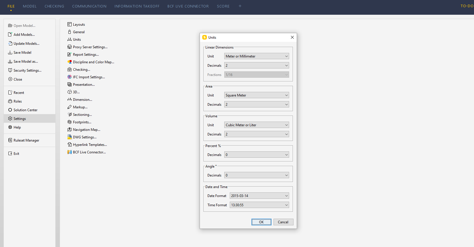

    why the settings is in meter but the result is in ft?

      Hi. The description is static text after it has been generated. So changing settings afterwards does not update it. But rerunning checking after the units have changed should update the description to use the new units.

        Hi, thanks for the answer but the situation remains the same after rerunning the checking after changing the units…

              @tina-ng said in different unit:
              yes but it doesn’t work.
              This does sound weird if the description otherwise updates, but the unit stays the same old one. I believe most likely what is happening is that the result is not being regenerated, either because the rule is not really run or something else. You can also try moving the rule parameter and changing them back to make sure the rule is rerun.

                @lasse-lindqvist Yes. You are right. Thanks so much!
