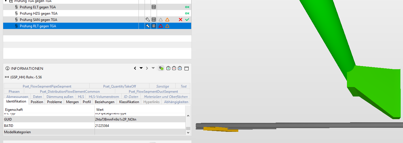

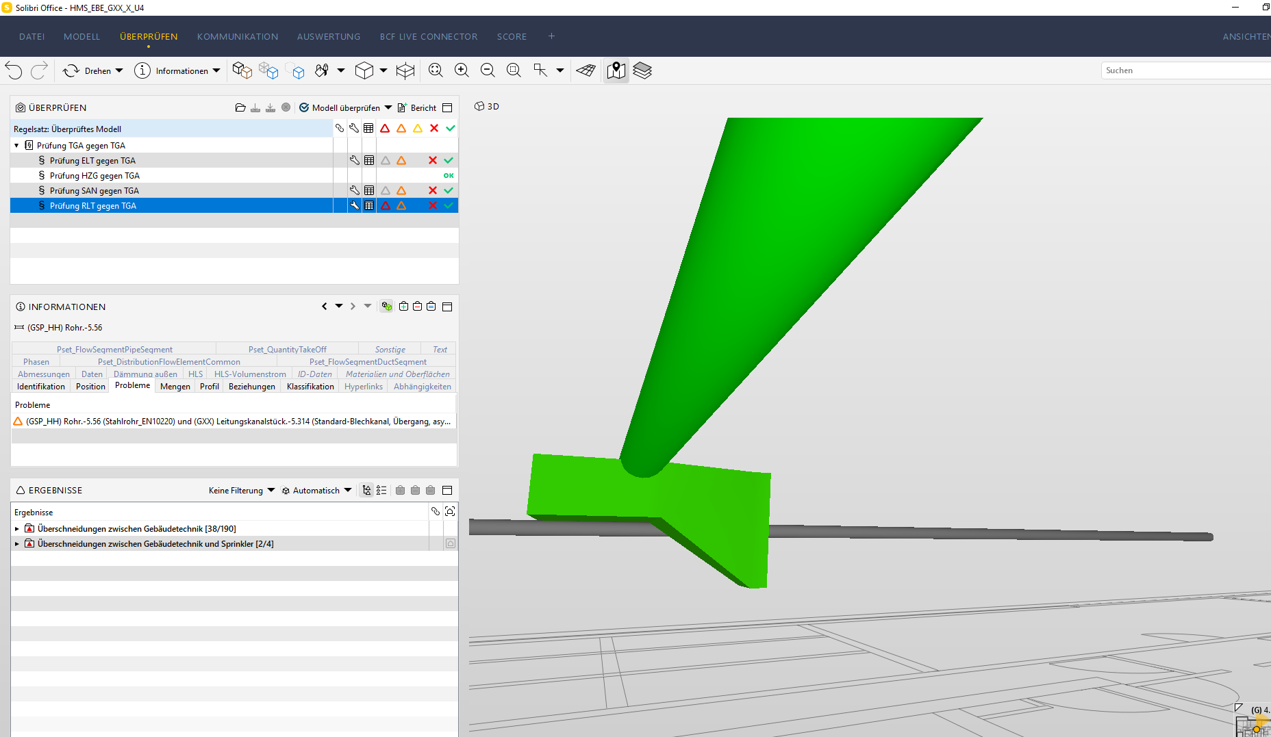

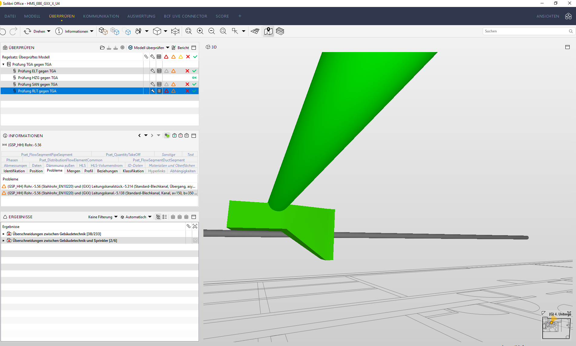

    recently i stoumbled upon an “bug” or an issue regarding clashdetection and Objects with boundary representations in their geometry.
    We recognized some false detected Clashes wich are not nice to get but acceptable. On the other hand we found many, many (very very much) clashes wich were not detected, what we think is very concerning (see screenshots below, file available on inquiry)!
    In our opinion the issue (wrong or not found clashes) is based on the geometry of the used objects wich is described as boundary representation.
    Please get back to me as soon as possible to discuss this issue, since this might lead to big number of not sufficient clash detections.

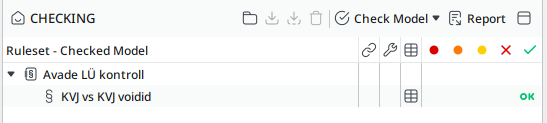

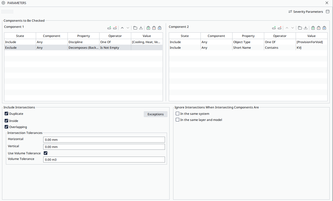

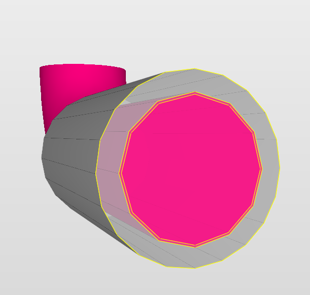

            I have found similar problem where Solibri does not find clash
            Pipe and ProvisionForVoid are clearly clashing,
            but no results are found.
            I added Solibri file, that can be downloaded from this Dropbox link:
            https://www.dropbox.com/scl/fi/a20b90adnrixc6wvtaq8l/Example.smc?rlkey=2cxxitofxsag2awv6pzxda1ov&dl=0
