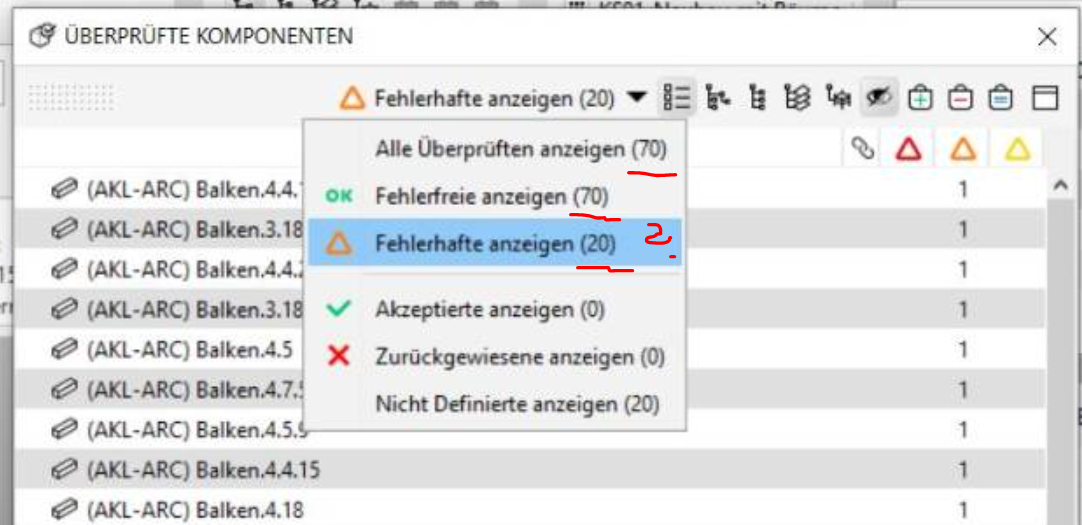

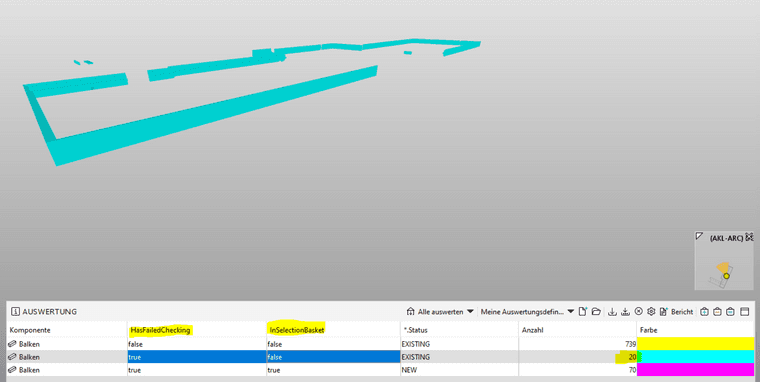

        Then there is the “Check Only Selected” way to do it but unfortunately this is resulting in a corrupt report as the numbers are simply not correct. My suspicion was always that legacy results from prior checking processes persist and confuse the whole story but I made some empiric test runs and no matter what I do I always get some incorrect rules. In the following for example you can see that some beams have failed checking = have issue although they were not selected. There have not been performed any checks with this ruleset before. Just this one. So the last hope and option to always have a virgin file (or ruleset) for solely performing property checks and exporting the reports until the gatekeeper issue might be fixed someday seems to be gone as well.
        70-70 =/= 20?
        In this issue example beams are getting checked although they are not selected. But not just beams, also other elements like doors or walls. So it’s not that thoese elements decompose into different parts or this just appears with exotic objects, it happens with everything but it is also rather hard for me to track down Solibri’s behaviour here as there is not really a clear pattern for me and that is even more frustrating.

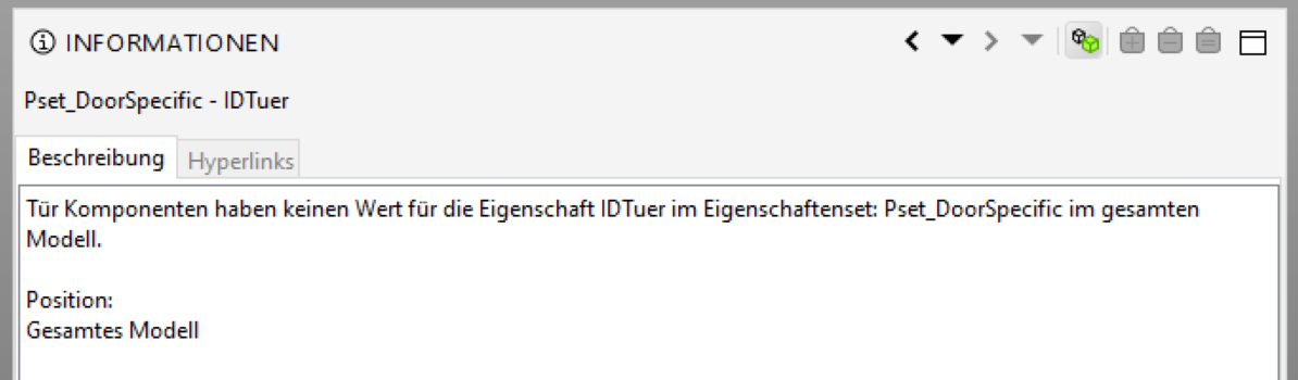

          Just a breif follow up to the previous post - I realized after half a day of editing rules that the looong way around isn’t doing the job either as desired.

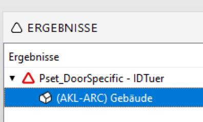

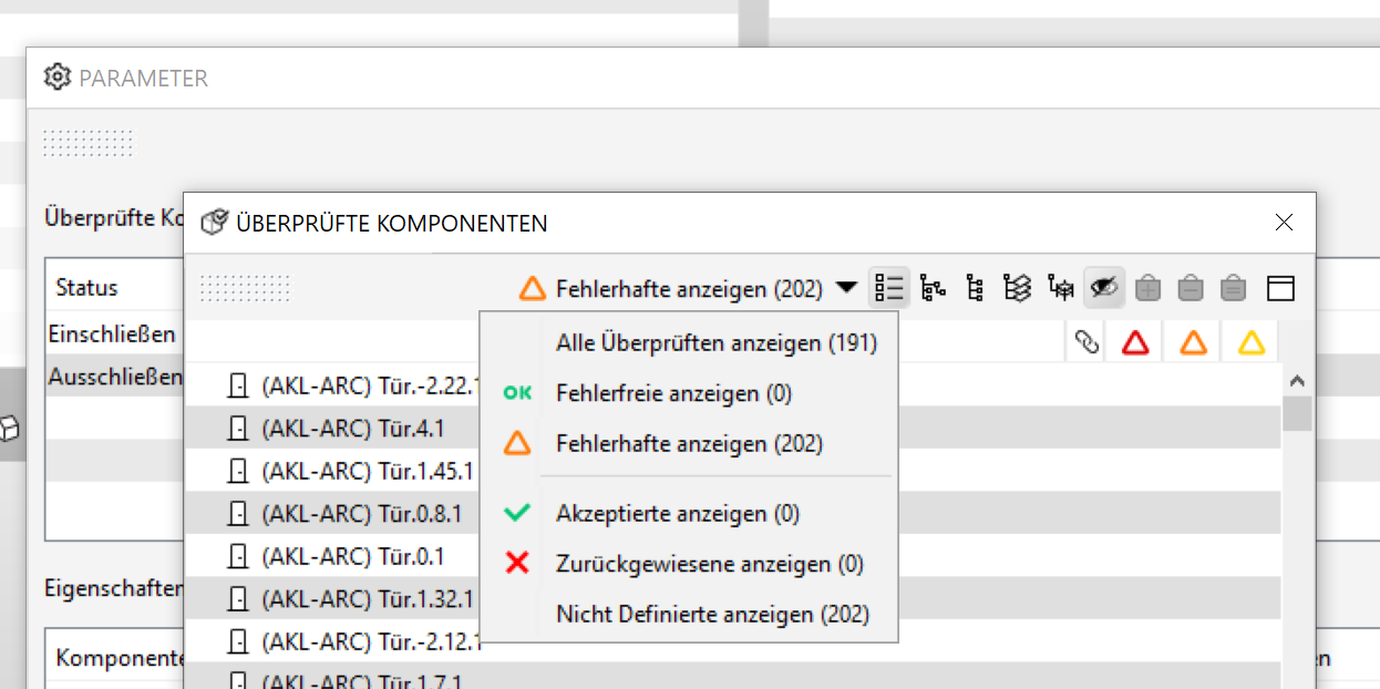

          Here you can see that if I check only parts of the model directly sliced with the component filter of the rule, then it does not give me the correct numbers either if the property is not existing in the whole model, as it falls back to the IfcBuilding for rule #203
          Sounds weird and confusing I know, I have once written more about it here:
          https://society.solibri.com/topic/1304/view-of-the-components-that-are-missing-properties-sol-203-2-4/4?_=1641223409175
          tl,dr: I have 202 doors in the model, 191 (new) should be checked for a specific Property(set), but it is no there. What I am supposed to get is 191 doors with this issue information. What I get is 1 issue for IfcBuilding but a total counting of 202 issues in the report. Both is technically not correct.

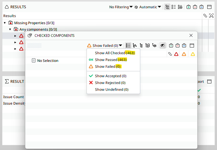

                        Hi @Solibrians ,

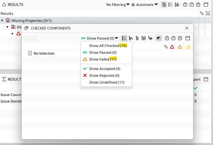

                        I’ve encountered a similar issue with Rule 203 and the Checked Components window in Result Summary.
                        In one instance, it shows all components as passed despite identifying that all components are failed.
                        For example, it displays “Show passed (463)” and “Show failed (0)”.
                        Conversely, in another scenario, it indicates “Show checked (15),” “Show passed (0),” and “Show failed (17)”.
                        Do you know how to solve this issue?
                        Thanks in advance!
                        3

                          Hi @Pegah,
                          I noticed the same issue too. Here is the link to the March post: https://society.solibri.com/post/11242. Unfortunately, the bug continues to be present in version 24.5 even though it should have been fixed “in the next release”.
