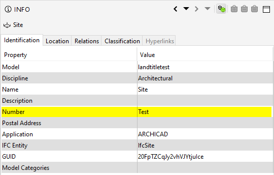

    Where is the attribute LandTitleNumber in Solibri?
    IfcSite should contain an attribute named “LandTitleNumber”

      @bimfront
      I tested by entering “Test” in the LandTileNumber attribute in an ArchiCAD, and the resulting IFC has the value under “Number” in the Identfiication Solibri properties.
