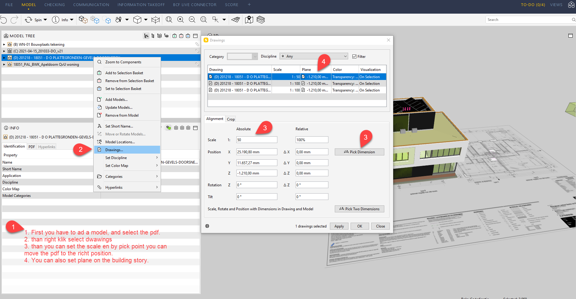

          Hi IFC Ghost,
          See the immage below. I hope this will help.

            @sander-Eikelboom
            Yes it is clear, thank you.

              You’re welcome.
              You can add pdf’s by selecting ‘add models’.
              As far as I know there is no way to creating rules for pdf files.
