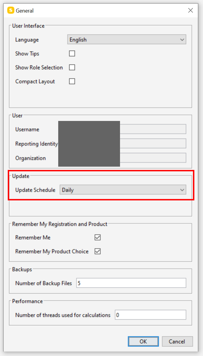

      replied to ZygimantasS on last edited by
      @zygimantass
      Under settings, general, you can set the update schedule. If you set this to ‘never’, it won’t give the updater on your start.
