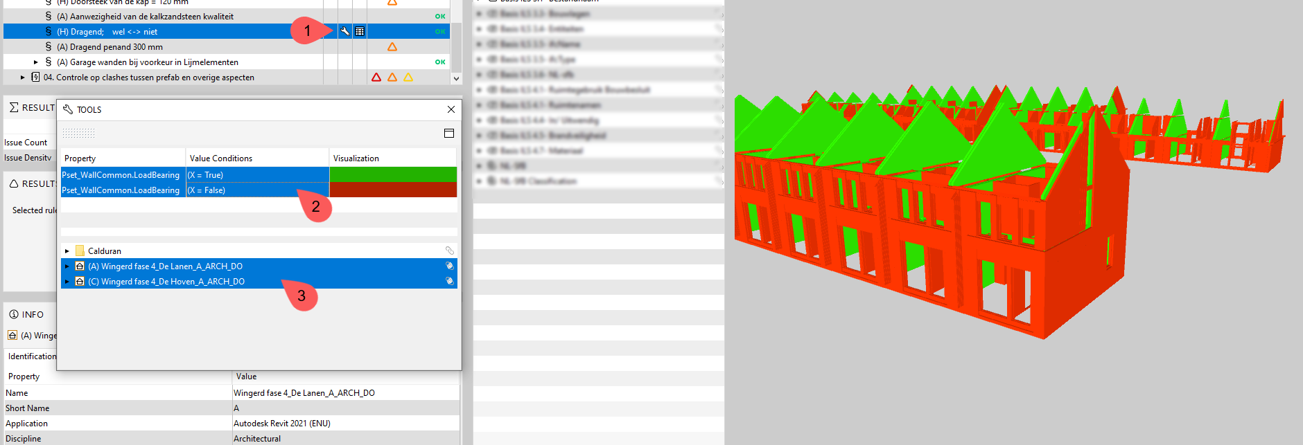

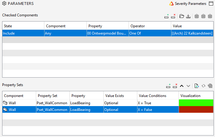

    I used rule 203/2.4 for the check (visual) if walls are loadbearing or not. This will help me and I think it is easyer than use another ITO or Classification.
    So I have set the rulet like the picture below:

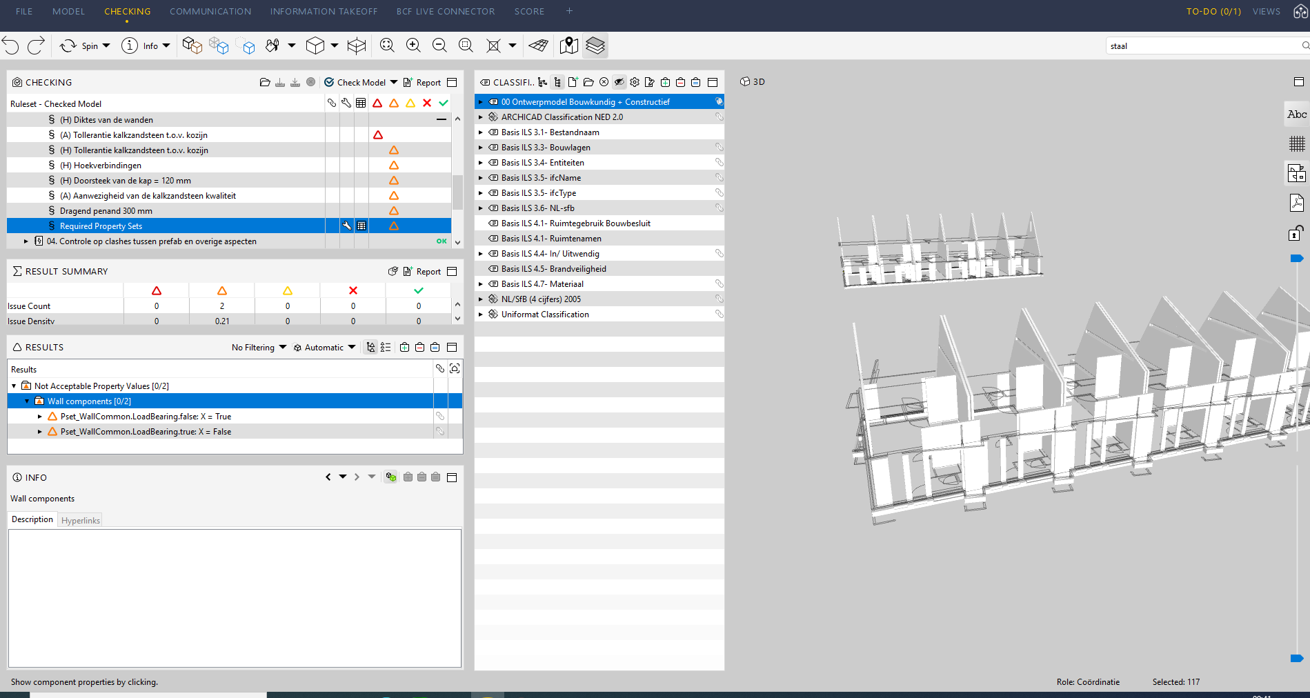

    But in the checking rule I see not a visualization:
    What I am doing wrong?

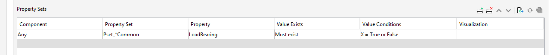

      Try ‘must exist’ instead of ‘optional’.
      If that also doesn’t work, perhaps check if it does when you place true/false in one filter row
        Sander E
        Thanks,
        It works, but not fine. After the check the rule says ‘ok’. But when I click on the rule tool (step 1 in picture below) I have to click on the value’s (step 2 and 3) and afther that I see my result in color.
        So I don’t know where the collors are fore,… but not for my wishes 🙂
