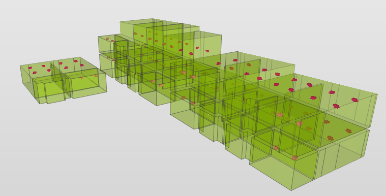

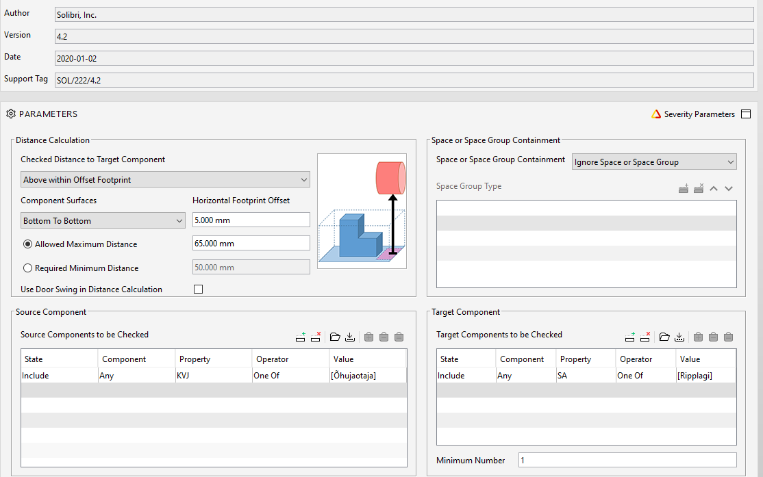

    Would like to run SOL/222/4.2 with this setting, but only for Air Terminals (Õhujaotajad) that are in rooms that have Suspended Ceiling (Ripplagi)
    Tried this, but get no results:
    General intersection SOL/1/5.0 (Space vs Suspended Ceiling) Check only failed components
    General intersection SOL/1/5.0 (Space vs Air Terminals) Check only failed components
    SOL/222/4.2 with above settings
    This gets me right Air Terminals
    Any ideas on how to achieve the desired result?
