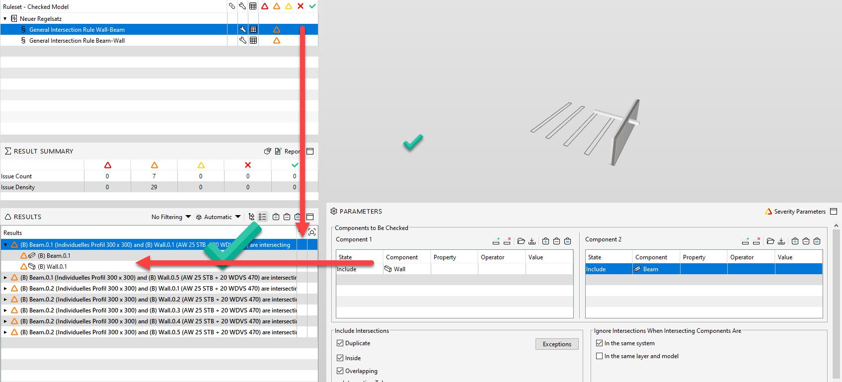

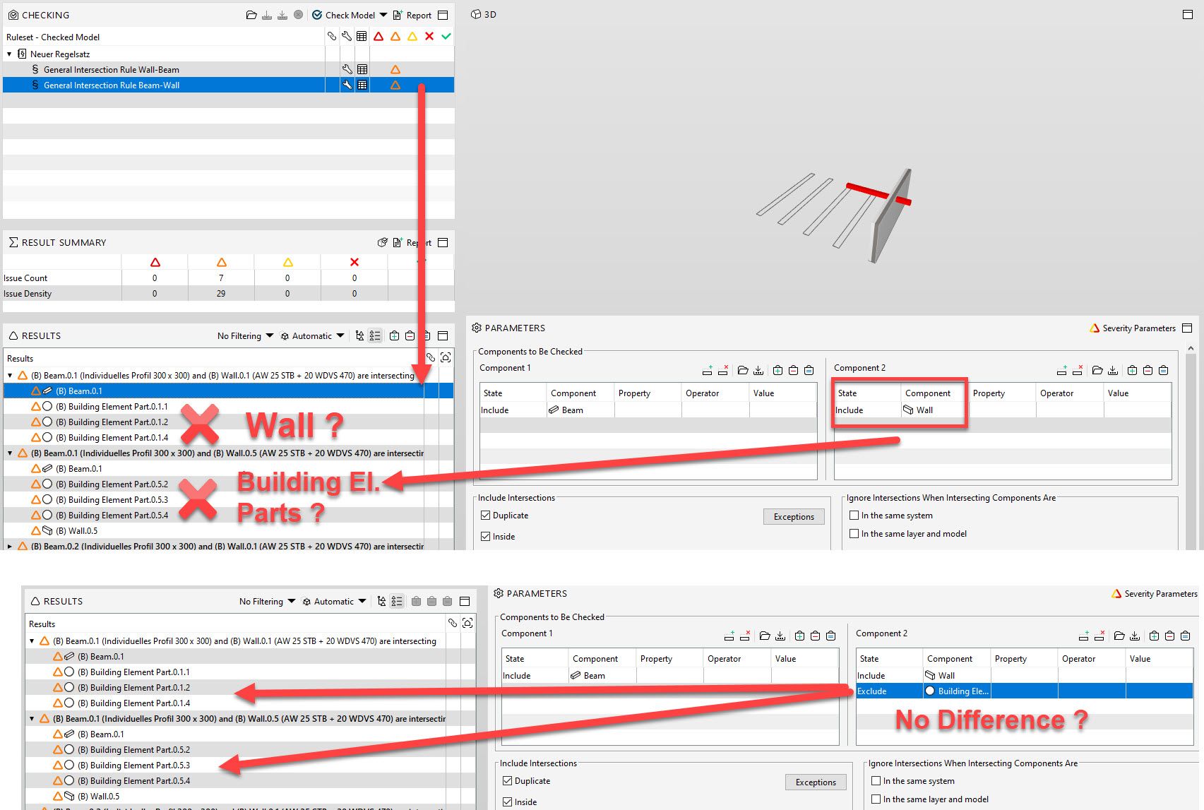

    Probably some have experienced a similar problem while working with SOL 01… there seems to be a problem while using complex components in “component 2” - it shows us also the collisions with the building element parts, even if we try to exclude those.
    what is your workaround to exclude building element parts?
    Simple Components work fine:
    Complex components always show the Sub Elements:

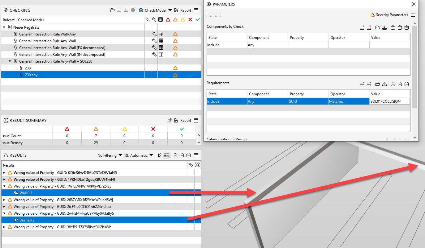

      I have not found an easy solution. if you think pre-/Postfiltering the results with a gatekeeper will give you the results… it only gives you separate elements in the collision and it does not matter how you filter them.
