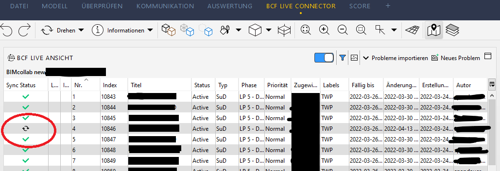

    Hello everyone,
    I have a little big problem with the BCF Live Connector and couldn´t find an answer in this forum yet. Maybe you can help me.
    The situation:
    My colleague created an Issue in Solibri with BCF-Live-Connector to a BIM Collab Zoom-project. That worked fine. The structural engineer got the issues and made some comments in BIMcollabZoom. That worked fine, too. So now I opened Solibri, connected to the Project with BCF Live Connector and found the issue with the comments. So far so good.
    After changes from me in this issue (added a screenshot, changed the description, made a new comment) Solibri or the BCF Live Connector changed the symbol in the column “sync status” to the classic double arrows. Now I worked with alle the mentioned issues and wanted to sync now.
    The problem:
    The “Sync-Symbol” doesn’t change. I still see the double-arrows and unfortunately the issues won’t sync… and additionally I’m not able to use the filter anymore. The filter is still active, but after clicking on it the window won’t pop up.
    What I tried:
    Automatic sync was activated from the beginning. So I unchecked this automatic and made a manual sync with “mark as ready”. The button for this was blue and could be clicked. Unfortunately this does’nt solve the problem - the double arrow is still there.
    So I tried to create a new issue. The creation was okay, but this new issue won’t sync.
    What I need:
    Maybe someone has an idea how to get the sync done. If not --> am I able to export an BCF from my changed issues?
    Kind regards

      Update for you:
      We didn’t find the problem, tested everything. Syncing was still not possible. Had to restart solibri and change the issues again.

          @8schrank8 , I have noticed that BIMCollb does not like special symbols in the title of the issue, I had a similar problem some time ago (I do not remember the character it was) but I removed all the " * - +` /%& etc. and then it worked. A bit hard to see if that is the case here, but since you have tried to make a new issue with the same information, it leads me to believe that there might be some information in the issue that causes the sync problem.

                Syncing did work again after the restart. But I have to say that I worked with the last Solibri-Version. So before the new start of solibri I installed the newest update. But imo it was about the restart itself and not about the update.

                That’s a nice little tip. I will try that the next time I get in this situation again. Actually there were " / " - signs and it’s good to know that sometimes it’s about this special symbols. But I agree with you that this shouldn’t be the problem, because I created a new issue that wouldn’t be synced as well.
