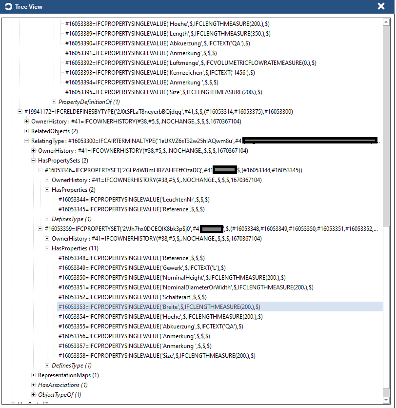

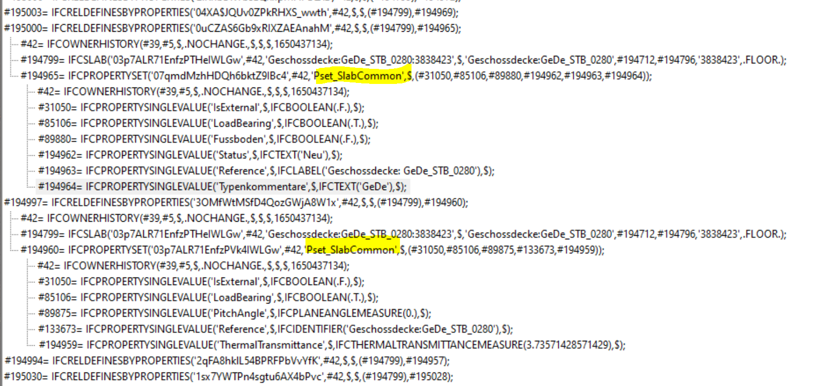

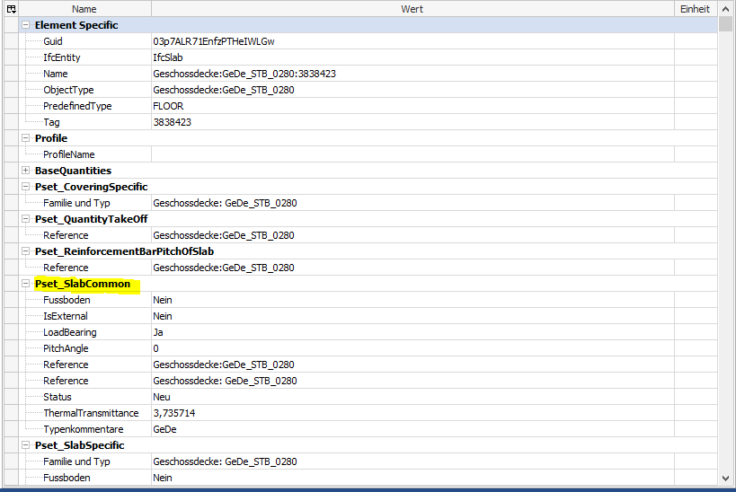

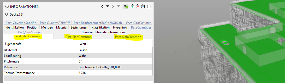

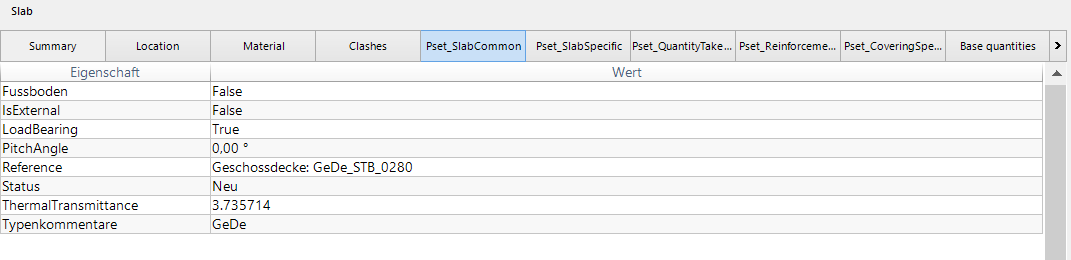

    Got this model here which derives from Revit and afaik the property mapping in this project has been a bit adventurous so far which is resulting in Solibri now showing the Psets of some elements multiple times e.g. here for this slab it has 4x the Pset_SlabCommon …
    I think there is no danger in having opposite values as the Psets are in principle showing the same values but are having more or less properties attached depending on how and where they have been defined in Revit. However could it be that Solibri for is now having issues in the property checking process as rules may e.g. just take the first Pset or shouldn’t this matter at all?
    Moreover, in other viewers the Psets are showing no duplicates at all but the greatest common Pset information so I wanted to ask also why this is happening at all and what are the usual strategies to deal with it normally?

          Hi. I think it could be a problem for you. At least if they would have conflicting values in different sets.
          Based on the picture it seems that Revit just exports the propertysets multiple times for some reason.
          Solibri supports importing multiple sets with the same name, but I have to say that the UI and checking logic does not work very well then. You could check for the value in a filter and there is no way to know from which set it would try to find it for you.
          As they are allowed in IFC, Solibri kind of has to import them.

              I think that a long time ago, merged such property sets, but then there were complaints that some values were missing, because there were multiple property sets with the same name and properties. Then we put some work to keep the property sets separate, since merging them is hiding a problem. This should be fixed at the source. That is, the software that is exporting the property sets should be configured so that only one property set is exported.

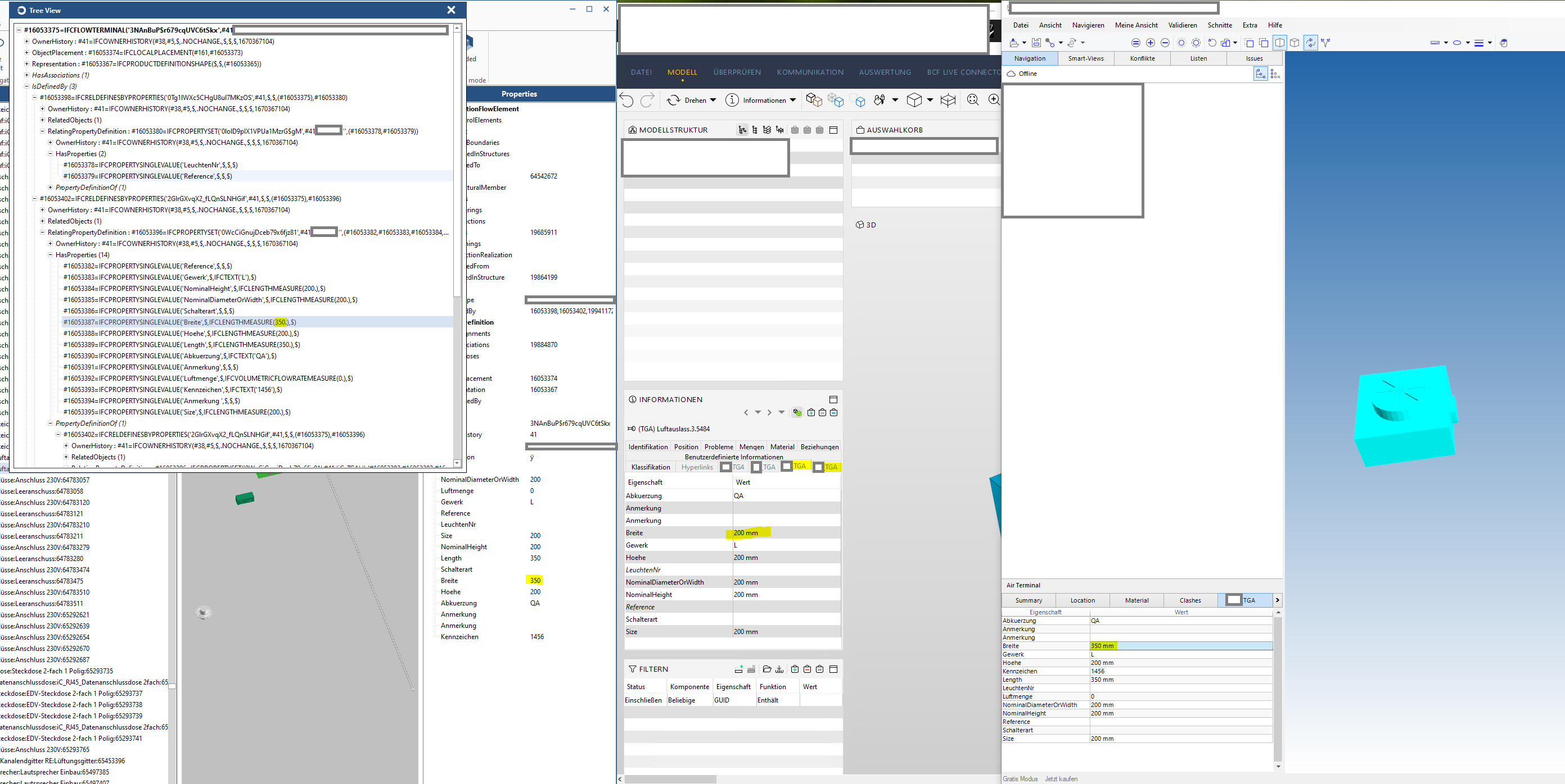

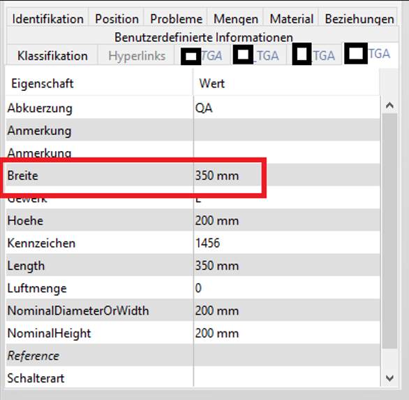

                My observation somehow is that only within Solibri this seperation of Psets is happening. So in this case the mapping of the follwing model example is indeed far away from being clean. I also guess it’s good to be able to have the opportunity to track this issue down and to be able to show them this issue within the IFC, but it seems like in other viewers the “correct” value is shown anyhow and that’s where I need more information if this is just a coincidence or if this indeed has something to do with the way related Psets are filtered out better/differently?
                Especially as there are other examples where Solibri shows no values at all for properties in one of the splitted Psets (and marks them as errors of course while checking) cause it “takes the wrong pset”. This is annoying but the bigger issue is the one above with the depiction of wrong values.
