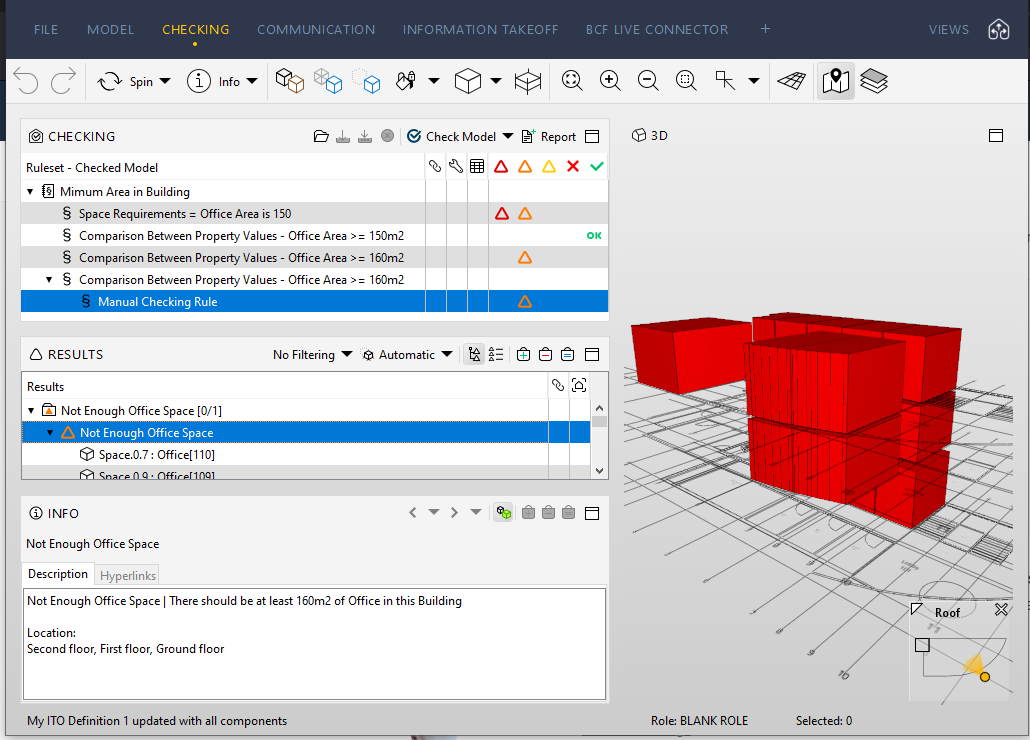

I would suggest trying the Comparison Between Property Rule 231 by checking the total area of the space in the architectural building that has the contains relation to the spaces.
You’d need to create a rule for each classification of space you want to check the minimum area for.
Also, the description of the issue results would say state something like : “Sum 157.91 m2 of the “Area” fails to meet the required value 160.00 m2 with operator ≥”
If you want something more descriptive, you can make 231 it a gatekeeper with a manual rule underneath with your own description returning the spaces of that category:
Here is an example of the Solibri Building checking for at least 160m2 of office space:
Solibri Building - Minimum Area in Entire Building.smcI’d recommend posting an enhancement request for rule 36 to have an across entire building or floors parameter and for rule 37 to add optional min/max area parameters in addition to a tolerance: https://society.solibri.com/category/18/feature-requests

This solution is working fine for this situation, altough it is a bit difficult for me to understand the exact behaviour of this complex rule nr. 231, but it is a verry powerful one and I think I will use for other complex checkings also.
Also thank you for the nice tip for manual checking results, wich gives a more user friendly description to the issue.
