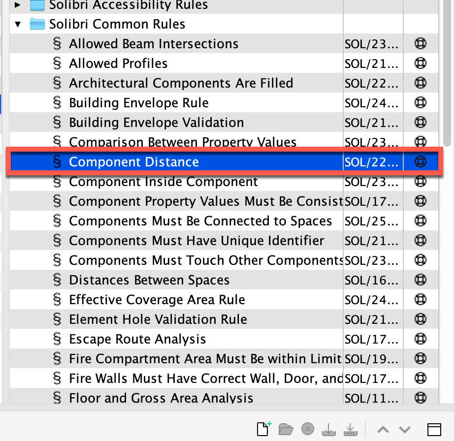

      Hopefully you can use Rule #222 Component distance to check the distance between components if you are checking for exclusion (minimum setting) or within a distance (maximum setting) to check if component conform to the distance requirements.

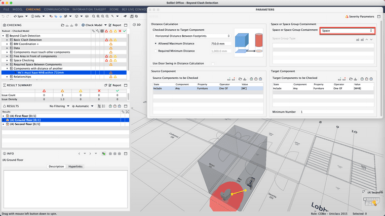

      Please see the example below where every WC requires a WHB to be within 750mm (don’t forget when using maximum distances you need to take into account the minimum number and this is initially set to 2).
      If you change the Space or Space Group Containment to Space from the default value Ignore Space or Space Group then you can ensure that it only checks distances to the target components based on the Source Component.
