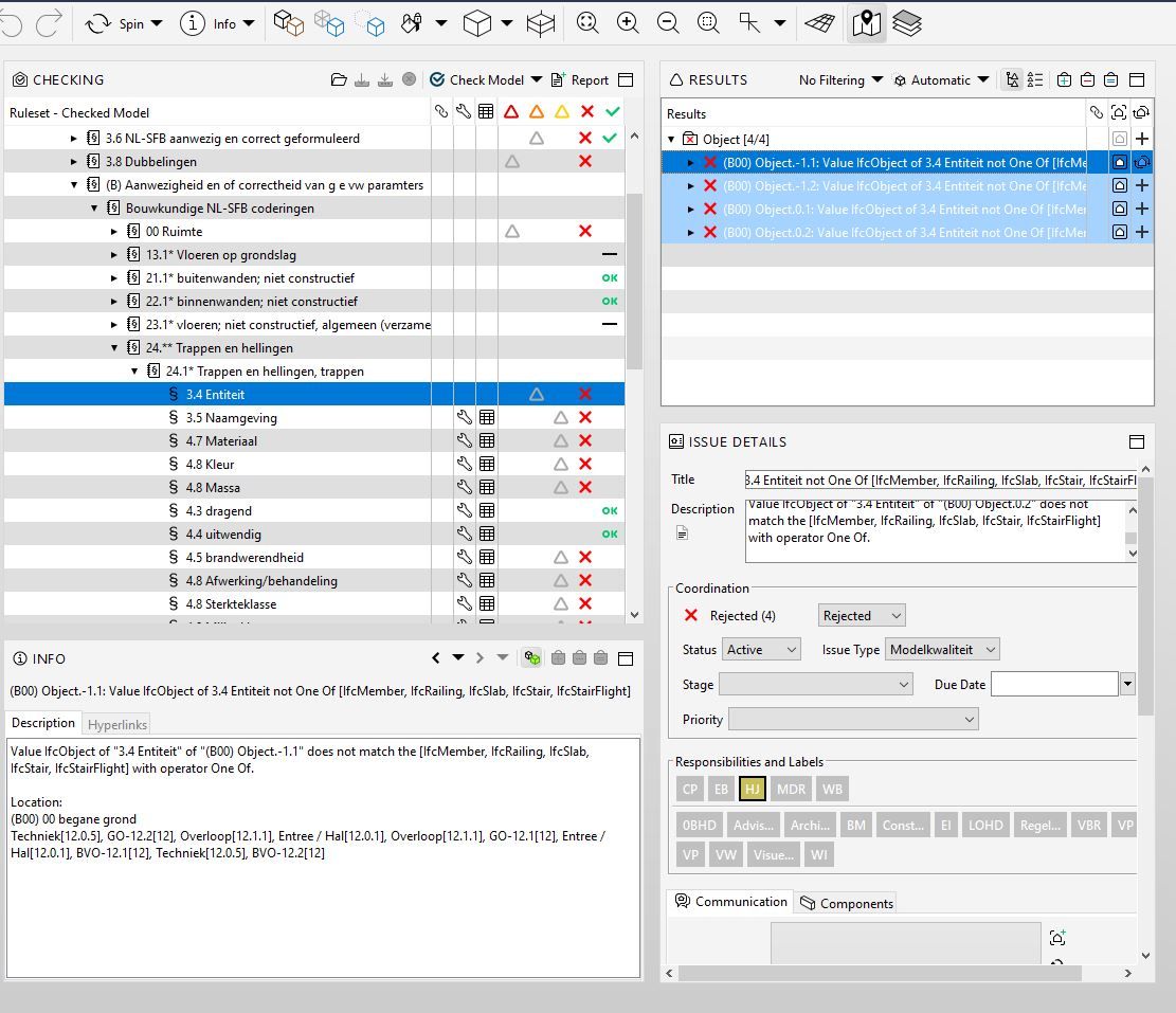

                    Issue in ruleset, this is exported to Bim Collab

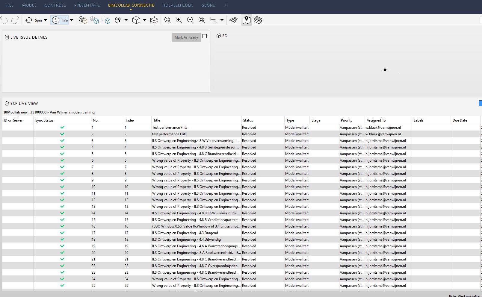

                    After theat i open Solibri, the smc and activate the BCF Live Vieuw again.
                    In the BCF live vieuw you see the stauts resolved.

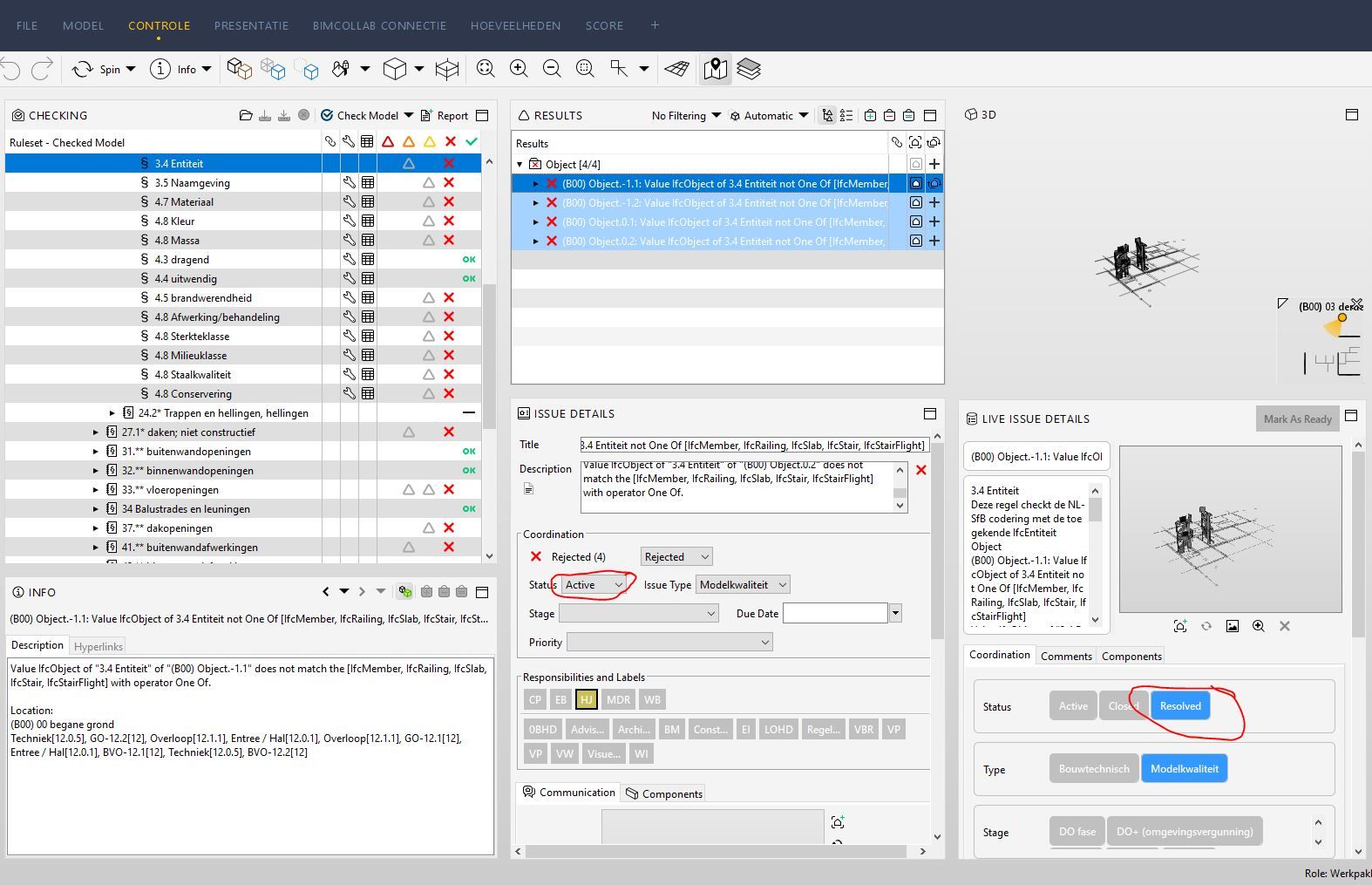

                    When i click on the triangle i go to the ruleset
                    You can see in the ruleset vieuw in the Issue detail of the issue the rulset the status is active.
                    But the issue in BCF live vieuw is status resolved.
                    This is what i mean.
