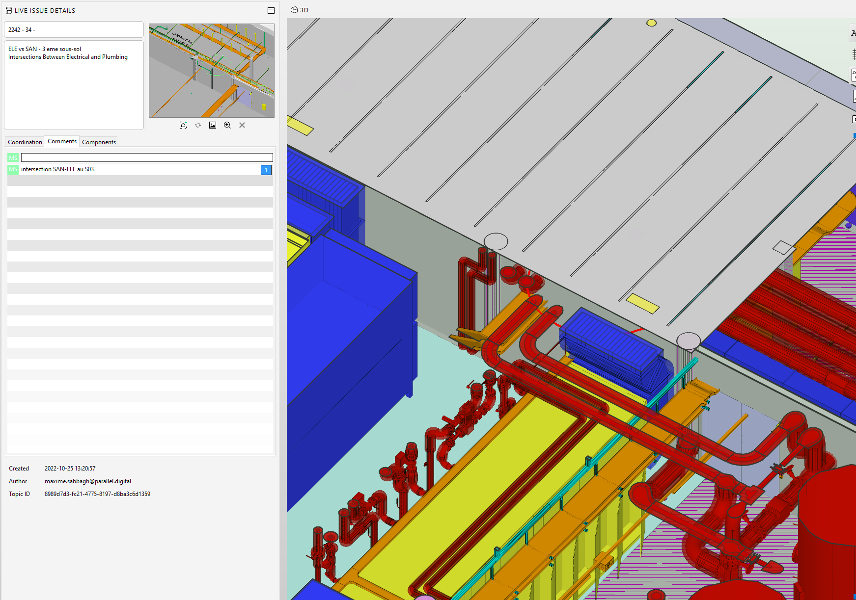

    Hello,
    I have a problem in the BCFLiveConnector. When I click on an issue, the image that appears in the 3D view is different from the one captured in the issue slide. All the models are on
    For example : a clash between Architecture and Electrical. So I turned off all the other model when creating the slide.
    And this is what appears in the 3D view when I selected the issue in BCFLive View:
    All models are on…
    Thank you for your precious help

      @Maxime-Sabbagh said in BCF Live Connector - Clash 3D Overviews:
      Did you mean to attach a screenshot?
        Did you sync with a server and if yes which one?
        How many components were visible in the slide? Some servers have limit for component count.

          • Maxime SabbaghM Offline
            Maxime Sabbagh
            As you can see on the screenshot when I select an issue in the BCFLiveView, the issue snapshot is different from the 3D overview…
            @Harmen-Jorritsma Yes this is what I did when creating the issue…
