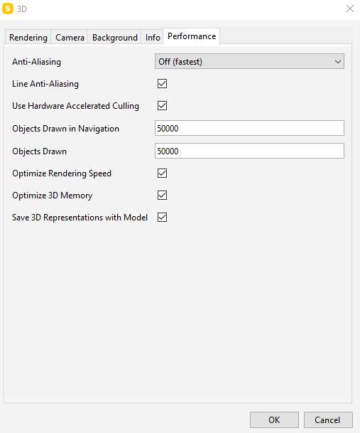

    Since the last update, my 3D view freeze every 3minutes, and freeze during 30 seconds.
    It is very annoying…
    This are my parameters :
    Do I have to change something ?
    How can I do for downloading the old version ?
    Thank you.

      We have got the same problem over here. My 3D view freezes when I use the Orbit Tool.

        Which Graphics you use in Solibri?
        See: File->Help (Application Info)

          I think I found a cause for freeze happening time to time when moving section plane with larger models.
          There is a workaround that might help also you.
          Please try adding this to: “C:\Program Files\Solibri\SOLIBRI-9.13.1\Solibri.vmoptions”
          -Drendering-force-data-mode-arrays=true
          We will investigate a better solution for the next release.

            The freezing happens here as well. It seems it comes with 9.13 version. I rolled back to 9.12 and the freezing seem to be gone now.
            I didn’t try the workaround but will try that later.
